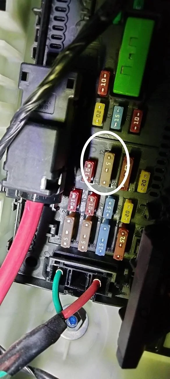

Pulling fuse 11/12 stops the telematics.

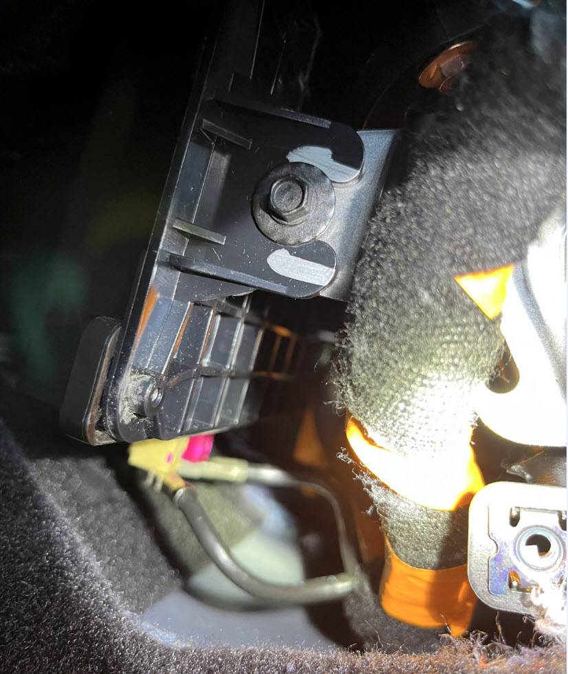

Start by going to the front of the passenger side footwell you'll see a plastic panel snaps into place unsnap it both sides at the top and one snap at the bottom be careful it is plastic.
You do not have to remove everything as I have.
Just above the carpeting you can see the square area that's where your fuse panel is going to be
Ford Maverick how to remove telemetric control module 20241123_095040

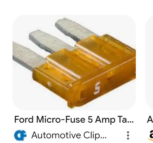

Here is the fuse box locate the 5A fuse in position 11/12. When you pull it out it'll have three prongs on it.
Ford Maverick how to remove telemetric control module IMG_20241120_142439
The fuse will look like this.
Ford Maverick how to remove telemetric control module Screenshot_2024-12-25-14-33-24-83_40deb401b9ffe8e1df2f1cc5ba480b12

nailed it.
what I find a little odd is why this is even a micro 3 fuse, since the third leg (fuse 12) shows in the diagram as unused.
I guess maybe it made sense in 2020 when finishing engineering on the 2022 model, but it's nice to not have to put a micro 2 fuse in.

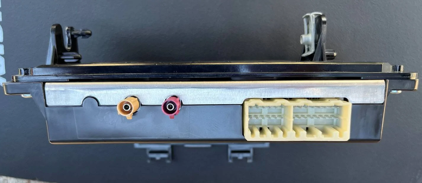

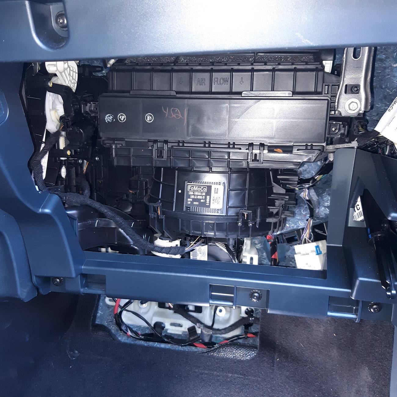

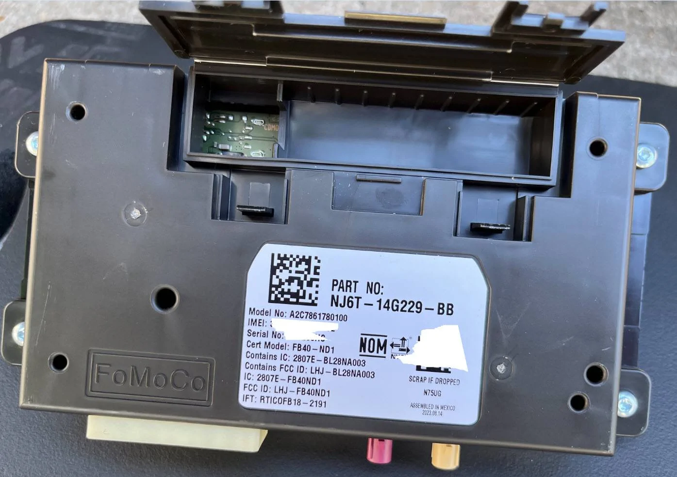

Pulling F11 works for me. I did want to see where it is so did look how to pull the TCU and see if it had a backup battery like some different TCUs have, like in chevys.
TCU from LH side of Floor Console tucked in behind HVAC control Module
Ford Maverick how to remove telemetric control module TCU fm LH Side of Floor Console w Coax Cables, FAKRA Connectors
Ford Maverick how to remove telemetric control module TCU Connectors
Backup battery compartment, no battery.
Ford Maverick how to remove telemetric control module TCU w Empty Battery Compartment
TCU has +12V, Ground, CAN Bus HS-CAN4 High, Low.

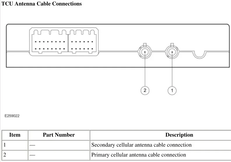

2 Coax for antennas:
Ford Maverick how to remove telemetric control module TCU Antenna Cable Connections
