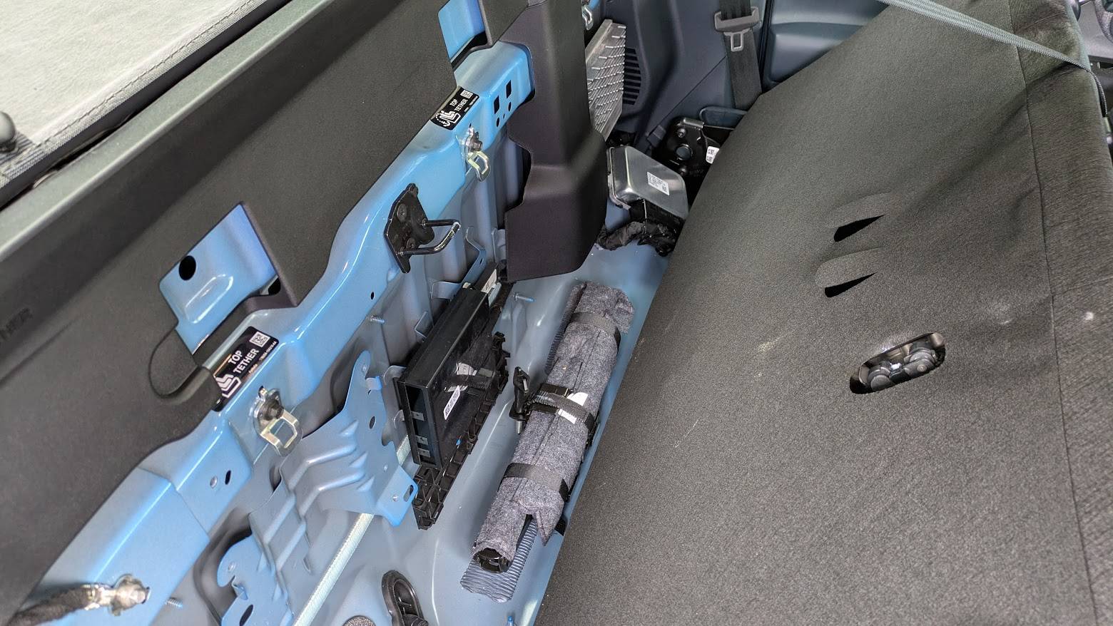

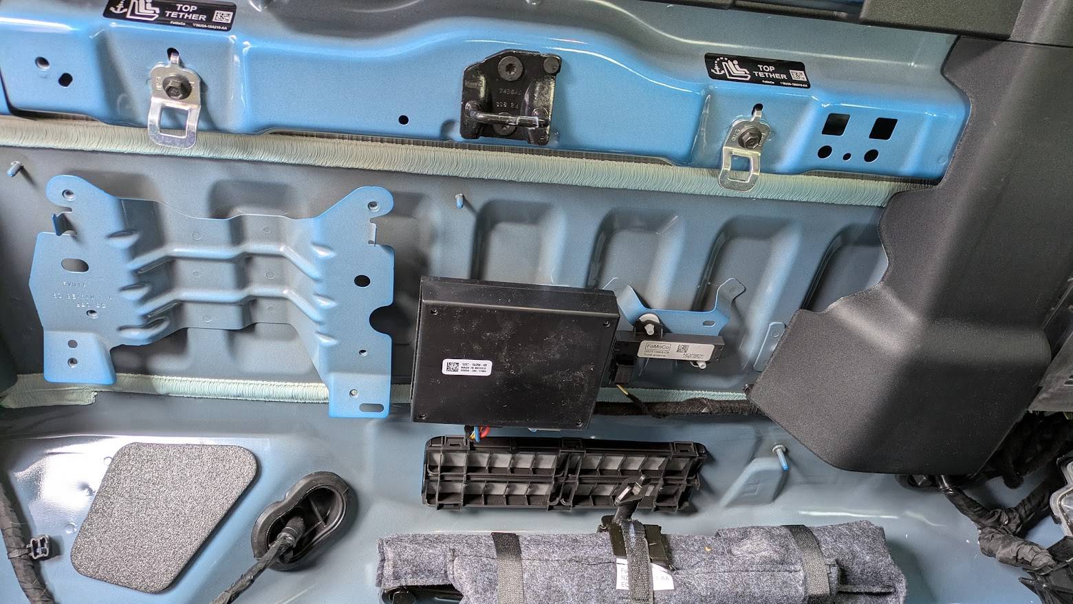

Here are some photos of my 2025 XLT to show what the OP is talking about. The towing control module is the black box in the center of the photo. To its right is the DS7T-15603-CA "Trunk Antenna" module. My towing module is installed parallel to the rear wall, and I imagine it would need to stay in this orientation if it does contain any kind of IMU. Though in Squirlz thread here, he did remove it and place it at an angle...

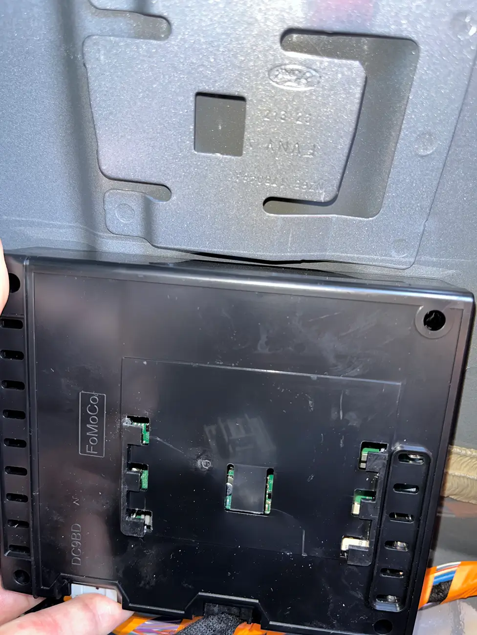

Well, if anyone stumbles in here trying to figure out how to get this thing off the bracket, there's a button in the middle on the back of it. You have to reach between it and the wall and push that button and slide it DOWN. Comes right off. There's a hole in the metal the button so just feel around until you hit that plastic nub.
