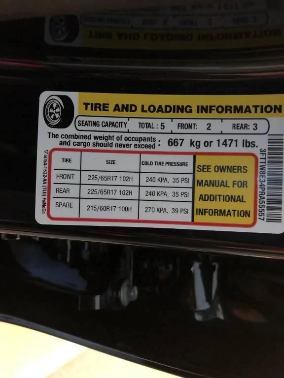

Thanks Metal. Looks like you are referring to a different version of the manual. Mine is for the 2022 Maverick and does have the info on the pages you reference. Front page actual part number for my manual is - 20210620211004143038 ( $%$#!!) Darnon, as I posted, the full size spare tire and wheel are identical to the other four. Being identical also means they are the same size and or dimension. The reason to to rotate is to equalize wear and also to extend the life of all the tires by using 5 instead of 4 in the numerator of the mileage equation. A spare like the Mavericks not used is a tire wasted. Typically they sit there upside down aging then rotting into uselessness if a flat doesn't come along.
Edit: Darnon, from your avatar pic looks like you have different nicer wheels. I have the cheapy bone stock metals . . ... all 5 identical. :)
Did you change/install your truck's spare tire yourself? Otherwise the 'full size' spare shipped with Mavericks is not the same size as the other (4) tires.... it has been discussed dozens of times on this Forum.
