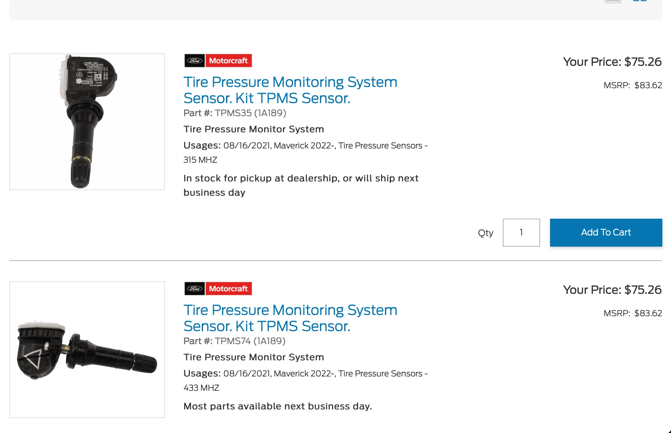

If you really want to be sure you can get a Ford TPMS tool for about $10 (knockoff) to $30 (Motorcraft).
Yep. Which is why I don't know the answer. I use a knockoff tool from Amazon to train mine manually. :)

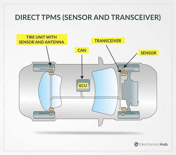

That is interesting that is able to auto learn the correct position for each new sensor, I'm curious as to how it does this. Do you have any insight into this @Discount Tire ?

If its set up like most vehicles, each corner of the vehicle has a individual receiver and thats how it knows…
