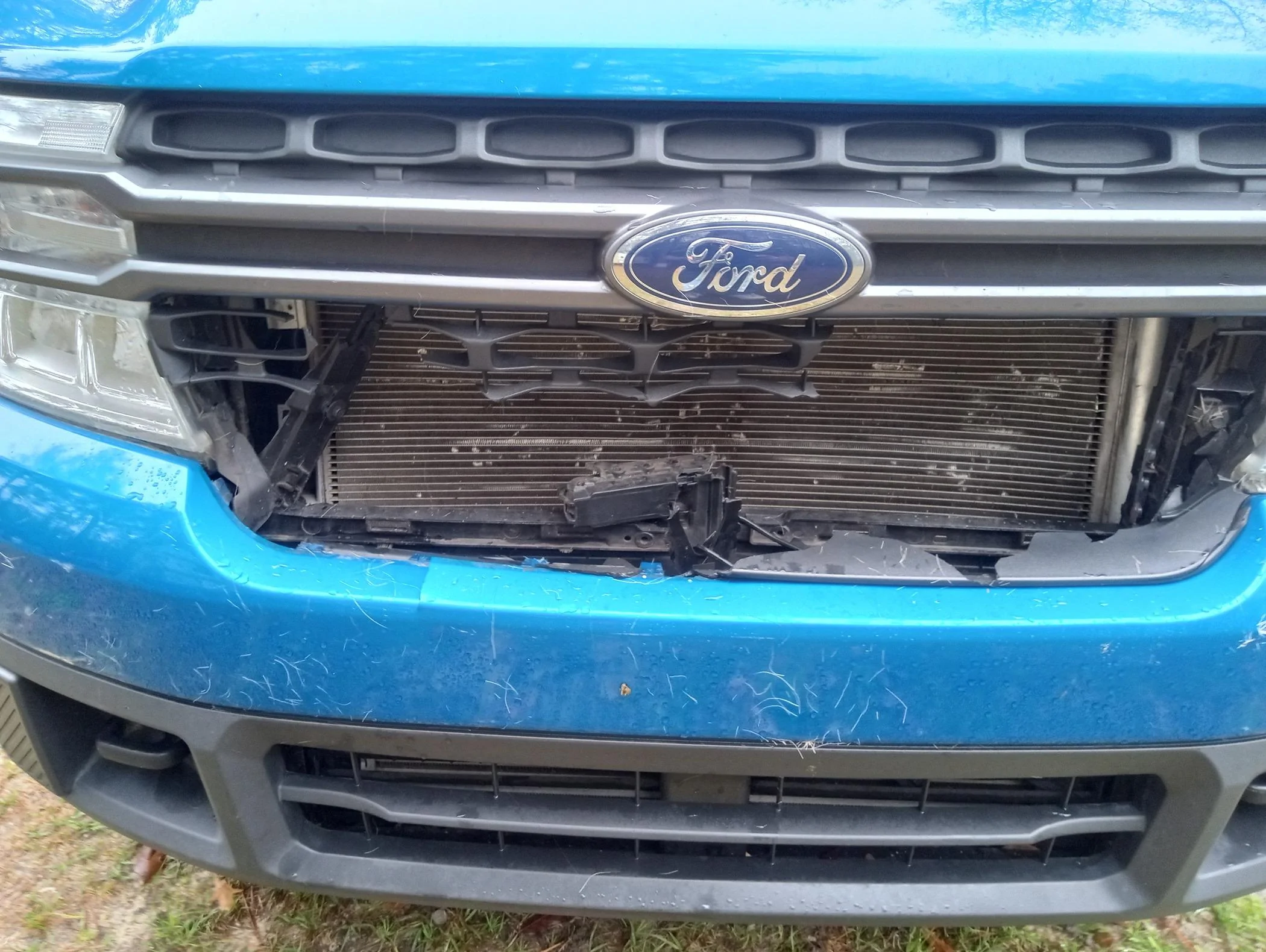

My shutters don't close anymore since I had my truck fixed after deer collision
Ford Maverick Hit a Deer and need HELP sourcing replacement Active Shutter System IMG_20240302_085156561_HDR
