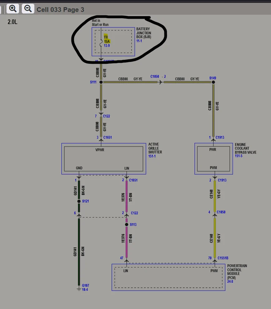

No code, was reading that maybe autobody shop did not recalibrate it with the new shutters, or maybe a blown fuse, but cannot find which one it is, owners Manuel, no help. Google search not helpful with which fuse either.
Perhaps they left it unplugged, or there is a problem with the wiring.
Check fuse 8, under the hood.
