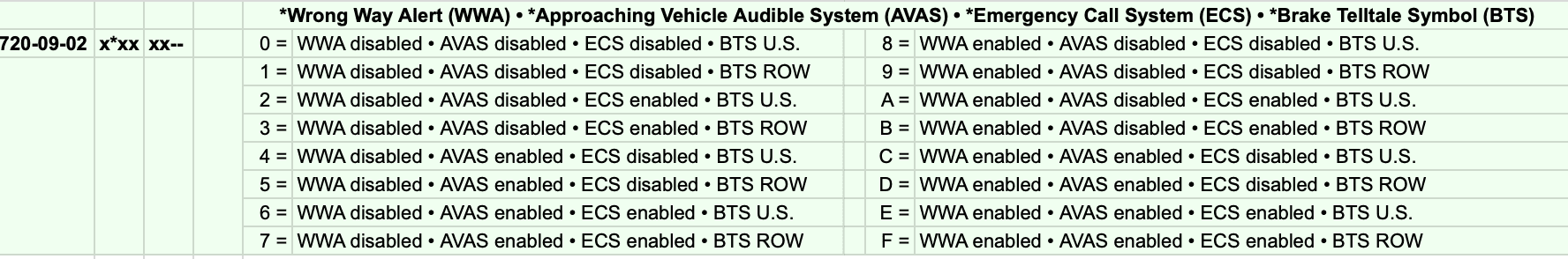

The second digit of this coding below is 0 on ecoboost Mavericks and is 4 on hybrid Mavericks. Meaning AVAS is enabled on Hybrids. I wonder if this is the noise.
