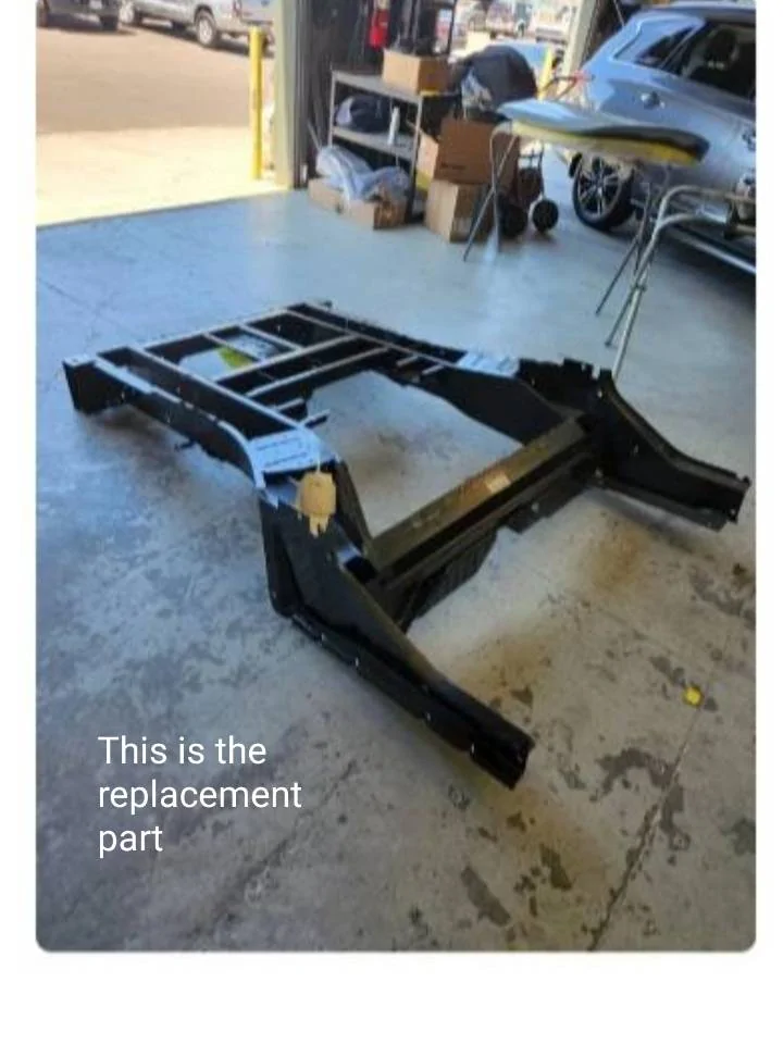

The body shop is telling you the truth.
Boron steel frames can't be straighten or repaired without affecting the integrity of the steel. If a Ford vehicle is financed through Ford Motor Credit and has damage to the boron steel frame. Ford will not accept a repair. The frame must be replaced. It doesn't really come down to the cost of the frame, it's the labor involved in replacing it
When the rear frames on a Maverick are bent. This is what has to be replaced.👇
Ford Maverick Hello and good bye : ( Truck totaled before I could make my first post .... 20241119_103840
  • Extremely High Strength: Boron steel is a type of ultra-high-strength steel (UHSS) with very high yield strength, making it resistant to deformation.
  • Manufacturing Process: The process used to create boron steel involves extreme heat, which makes it very strong but also brittle.
  • Risk of Cracking: Attempting to straighten a damaged boron steel part will likely cause it to crack.
  • Heat Sensitivity: Applying heat to straighten the frame weakens the boron steel and compromises its structural integrity.
Anyone who says that they can some how repair or straighten a bent Boron frame without affecting the frames integrity. Has little or no Integrity themselves.
