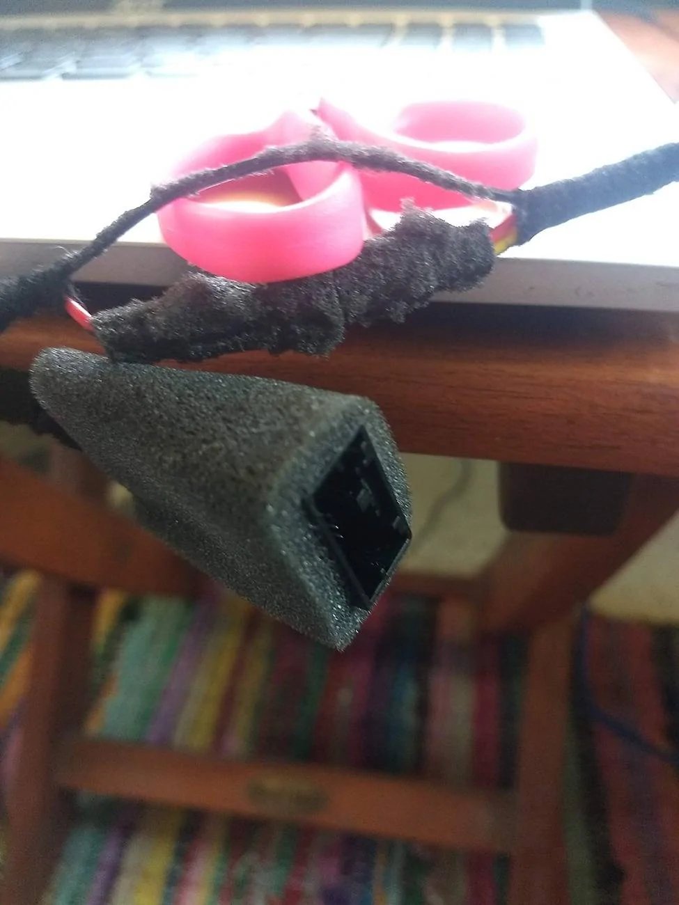

I ordered a Mangoal dash cam based on the YouTube video from Fred's Garage. I even followed the link provided from YouTube. What I was received was different. Fred's showed a hookup into the OBDII port. Regardless of what you think about it, it did look easy. What I received only included a harness to tap into the Lane Assist port with pass-thru. I only have an XLT hybrid. Maybe I will get luck and the port is there but maybe not. Also what I received has the built-in port to add a GPS receiver. I don't need that but it's there and was not shown on Fred's video.
It is a bit odd in that the power port to the camera shows Red/Yellow/Black but the tap to the Lane Assist only shows red. The instructions assume plug and play so don't really spell out if Red is Acc or Yellow is ACC.

You are way overthinking this. What you received is significantly easier to install and will provide better results.

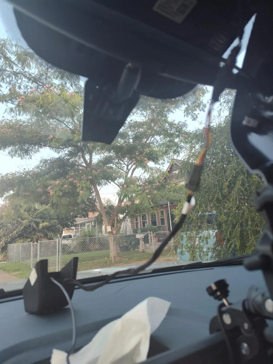

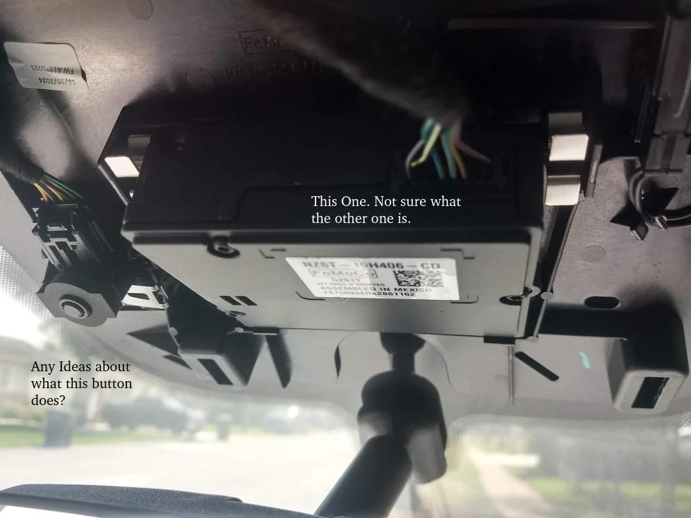

Success!!
Ford Maverick Mangoal Dashcam has changed and not in a good way for me. TestFitMaverickCamera
Ford Maverick Mangoal Dashcam has changed and not in a good way for me. Maverick_Mirror_Connectors_with_text_Shrunk
My 2024 Hybrid has the lane assist plug for the Mangoal pass-thru that came with the kit. The center console trim was more difficult to remove than I was expecting even after cooking in the 90^ sun for a couple hours but it came off and no clips were lost or broken.
The Mangoal wiring harness pass-thru to the lane assist is a bit odd. It is three wires RED/YELLOW/BLACK with red being ACC and YELLOW being constant hot per vendor supplemental kit. But in the provided lane assist pass thru only RED goes to the truck harness and the YELLOW is tied into the same fuse holder as RED. If I am feeling really ambitious, I stripped away enough wire tape to run a real constant to YELLOW with a separate fuse down to the passenger footwell. But FordPass is already bitching at me that I don't drive enough and disabling Remote Start. Remote Start is such an weird feature, especially for a hybrid with an apparently weak 12V battery per other thread.
Both apps worked, Viidure and SkyCamm. They seem to have identical functionality so not sure why both are recommended. At least in vertical mode, they are close to useless in real-time. I kind of like Torque-Pro in vertical mode better than horizontal but maybe this will compel me to change my phone-holder orientation.

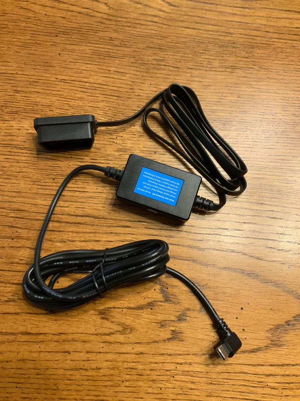

I use the OBD II Port to power my dash cam it’s very simple and it works great however I had to purchase this separately it was not included with the camera.
