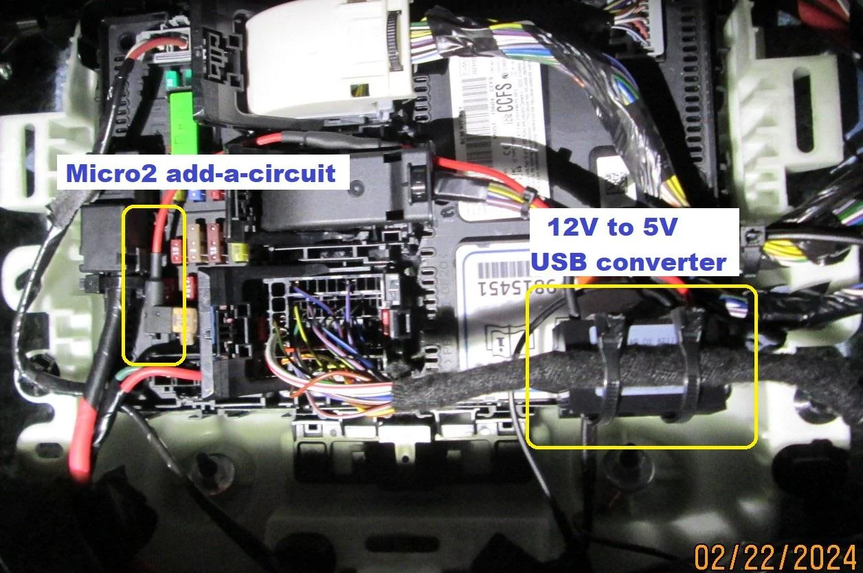

I just installed a Garmin 67W, which came with a USB cable for power, so I bought a 12V to 5V USB Converter, and used a Micro2 add-a-circuit installed in the Micro3 un-used fuse location 1/2, which is switched power. If you also need un-switched (on all the time) you'll need to add a 2nd tap. This is the fuse box location under the glove compartment.

Ford Maverick Dashcam OBD2 connection wiring USB Converter w notes
