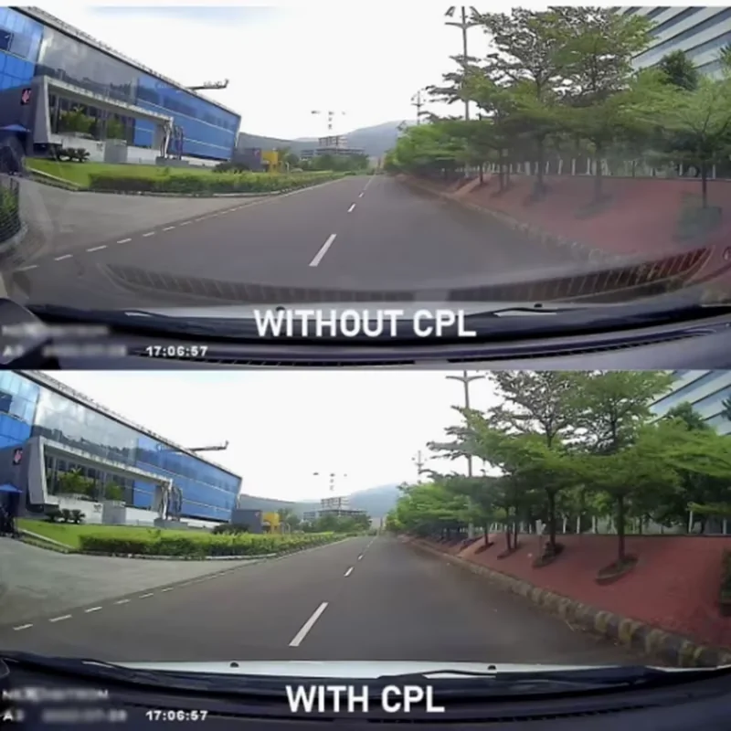

fyi if you get a polarizer you'll dramatically cut down on those dashboard reflections
Also a dark dash mat helps and that includes the drivers vision, not just the camera :)

Yeah, reflections are such a pain, especially on the Maverick with that dashboard slope.
