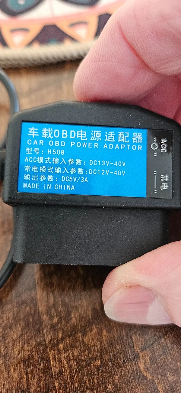

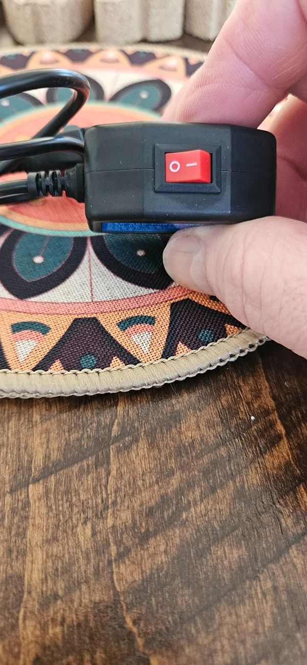

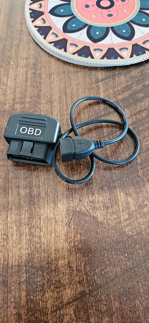

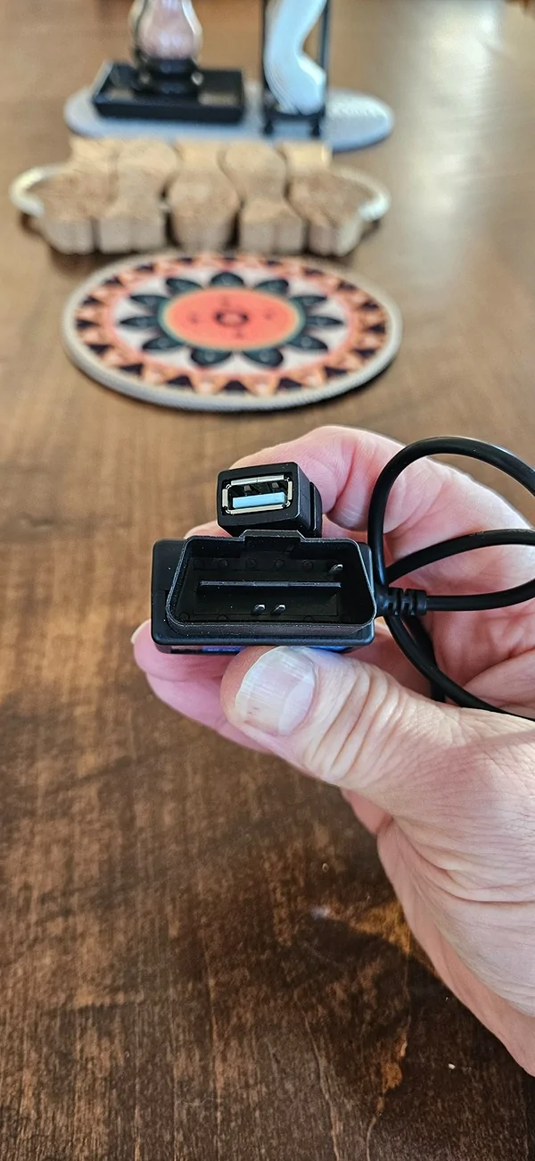

We only use the OBD II port for powering our camera but not for data logging in any way.
When we arrive at home I automatically unplug the cord from the camera and plug it back in when we leave again, just to make sure the camera doesn't suddenly start draining the battery. We don't need the camera to wake up and record in our garage.
When we are out and I am not waiting in the truck, the camera is still active and if anything happens while we are away, it should capture some useful video for us.
Our above cameras have a sensor to come on if struck while we are away,
Normally you need to hardwire them in but I think this works as well depending on the manual switch selection on the OBD device (I have a spare just in case either OBD in our camper van or truck fails that i have an instant replacement.
Data logging shutting down after turning of the truck makes sense as well.
Here are pics of my spare OBD device for those who may be learning about them reading this post.

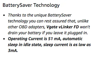

Mine.
https://a.co/d/7O23L0d
Almost curious now if some of my truck sleep mode higher avg mA readings (60-80 mA) during shorter stops (30min) , is this device turning back on while truck is doing it's intermittent checks, causing data to be seen at the port.
I figured it was the ACCM issue occurring briefly into sleep mode to be logged there, but maybe it's this waking back up.
I'll have to start unplugging it to see. Not enough to drain a battery overnight by a long shot even if enabled the whole time, but still a system (device) that could have it's own ability to flake out and not do what it claims.

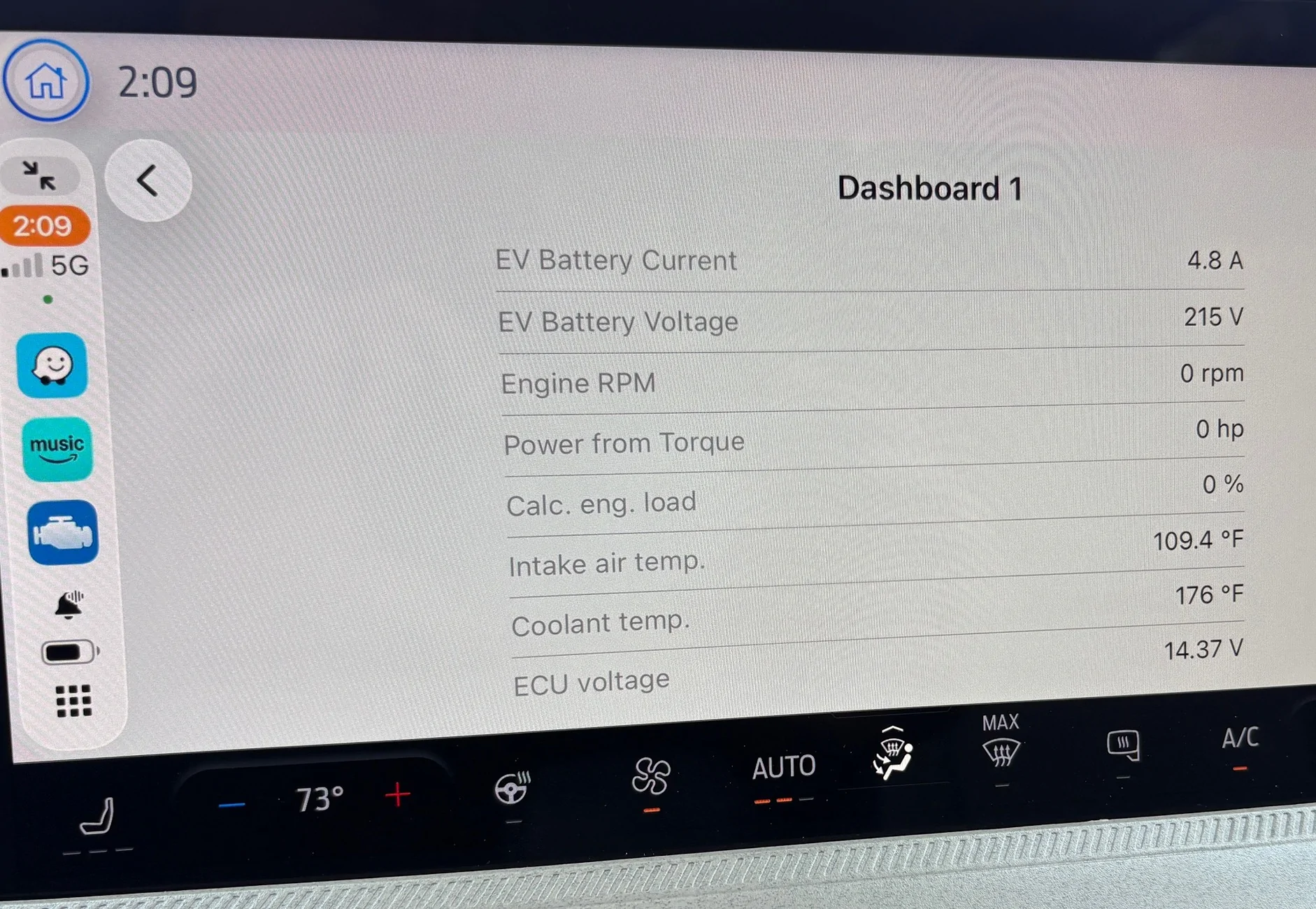

1. Yes. I use the free version of "Car Scanner" - the app itself has cool graphics but on CarPlay the dashboards are only 8 lines of text. Works fine though. Quick updated.
2. The carplay app has a "connect" button so if you close the app, you need to re-connect. It's minor. M don't use it all the time, but it's there on the sceen if I want it (I usually have a WAZE map on my CarPlay screen.
