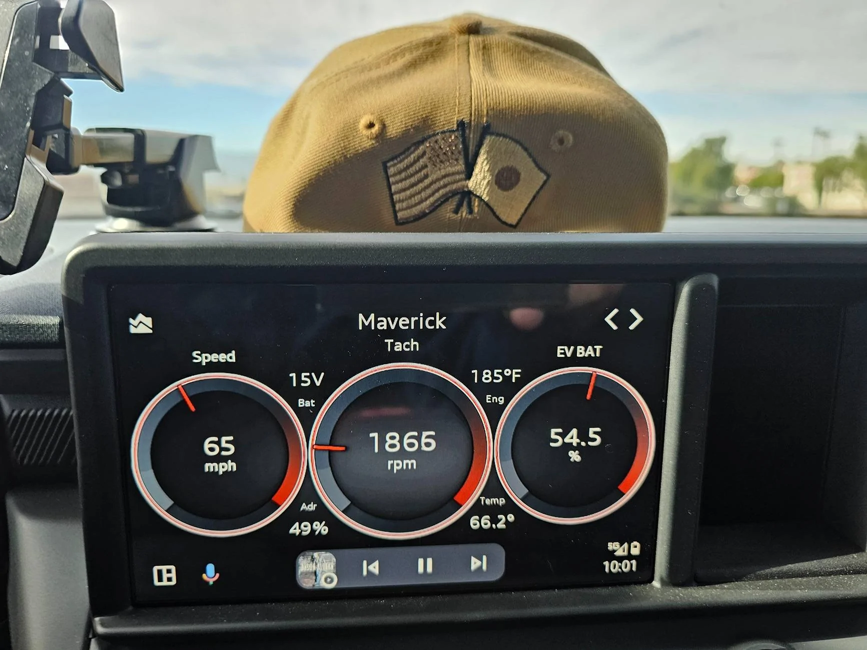

Lots of possibilities with a hybrid. This was my 24 Lariat with CarScanner & dongle in OBDll port. Tach is on the “bar” across the bottom. Other are correct, it‘s not real exciting on a hybrid, but it is interesting to watch
Ford Maverick Has anyone added a tachometer IMG_1812

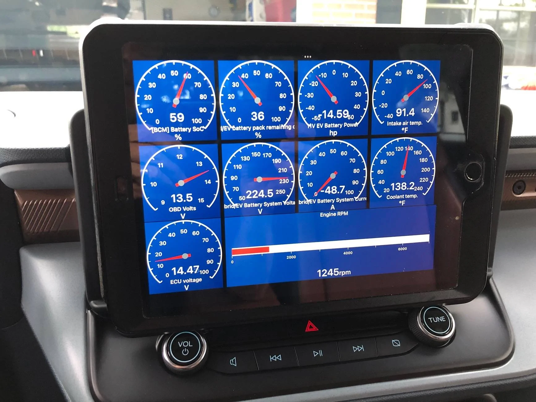

Still, I'd like to see it. As a diagnostic, out of curiosity and because it's familiar. I'd also like to see a couple of volt meters and a temp gauge.
See post #13. Lots of Voltages & temps available.
