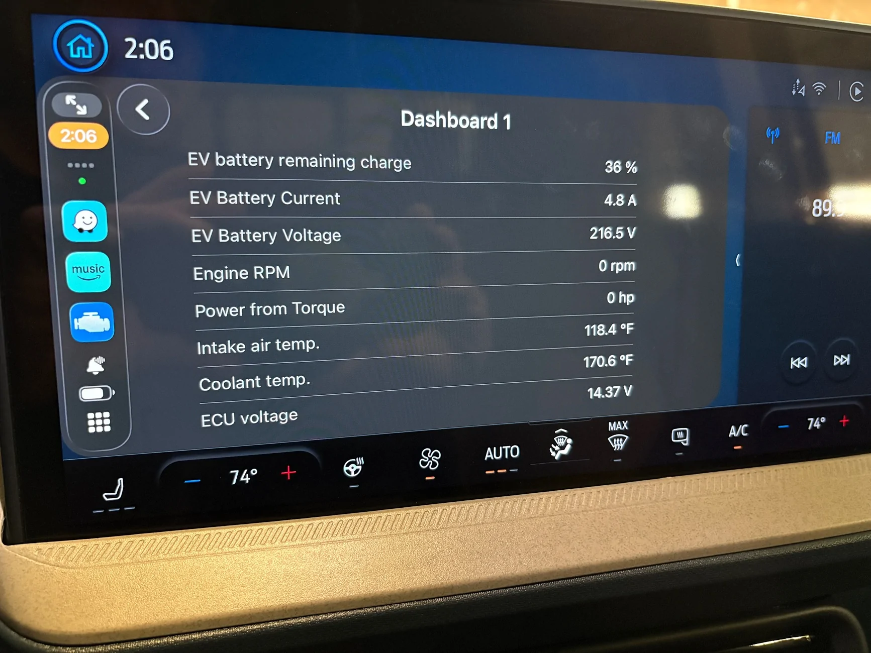

Are we saying the tachometer “can be“ displayed on a 2025 Lariat AWD Hybrid?
Nope. The original question was about a 2025 Ecoboost.
You can read the rpm’s via an obd2 Bluetooth connection and sw. I use the free version of car scanner and put it up on CarPlay…
Ford Maverick Tachometer - how to display? IMG_0536
