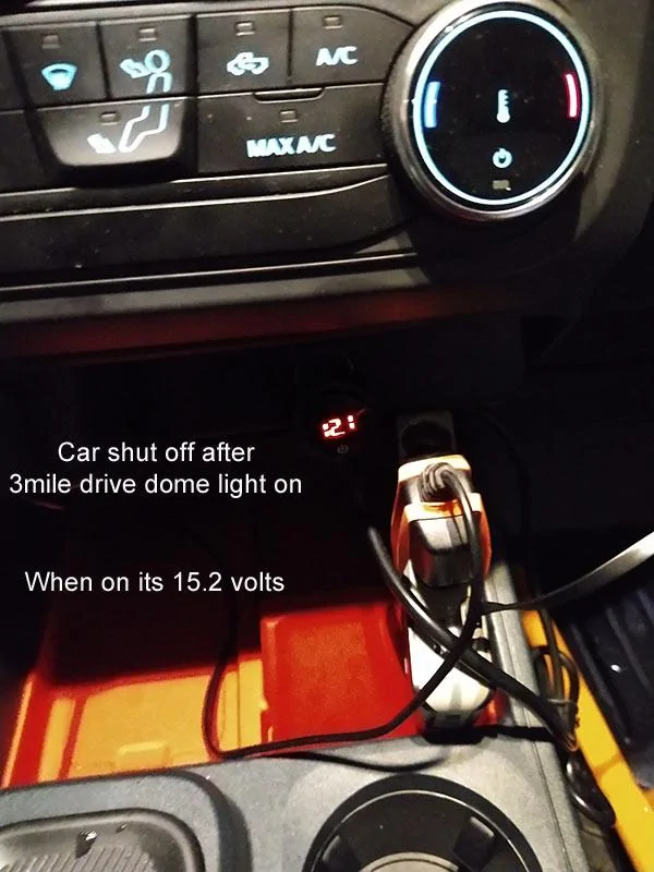

I have a voltage readout on cigarette connection as its also a on off switch were i connect my dash cam. So I can read both output when running about 15.2 volts and battery voltage which last I looked I THINK as I didn't record it was maybe 12.3 volts. . I will state taking picture of that readout and keep a record on it. I hate not having a dome light.That sucks.

Went to gym about 3 miles from home. In gym 1.5 hours, had no dome light when I got in car and none after drive to gym. After return I had dome light but it only lasted maybe 30 seconds but lighter stayed powered after car shut off. It wasn't earlier today. It normally stays powered after shut down till I open door.
So I have about 12.2 volts on battery alone. Not sure what percentage that means its charged? I will charge battery if it ever stops snowing. I will charge under hood at jumper locations rather than at battery directly.
I have that recall for bulbs and haven't yet had it done I will wait till after I try charging 12 volt battery to see if dome light keeps working. If not when I do recall I will have dealer check battery.
My setup has a switch with digital readout on push button on/off switch. Part of my dash cam setup . Two pictures when I got home
The voltage you see at the dash power port is not the actual battery voltage. It is the voltage at that point on the 12v bus. The battery voltage will be reduced by other items which are pulling current. Sit in vehicle, turn it off, turn off the lights with the dial left of steering wheel, voltage reading will climb, as well as radio, will climb. If you leave your voltage monitor on when you exit your truck the dash power point will keep the current flowing for the chosen time off delay occurs or when the 12v soc drops to 12.1v. (I am not sure if all models have the battery saver option). I also double lock my hybrid with the key fob as this turn off the courtesy lights, radio, dash immediately instead of waiting for timer off.

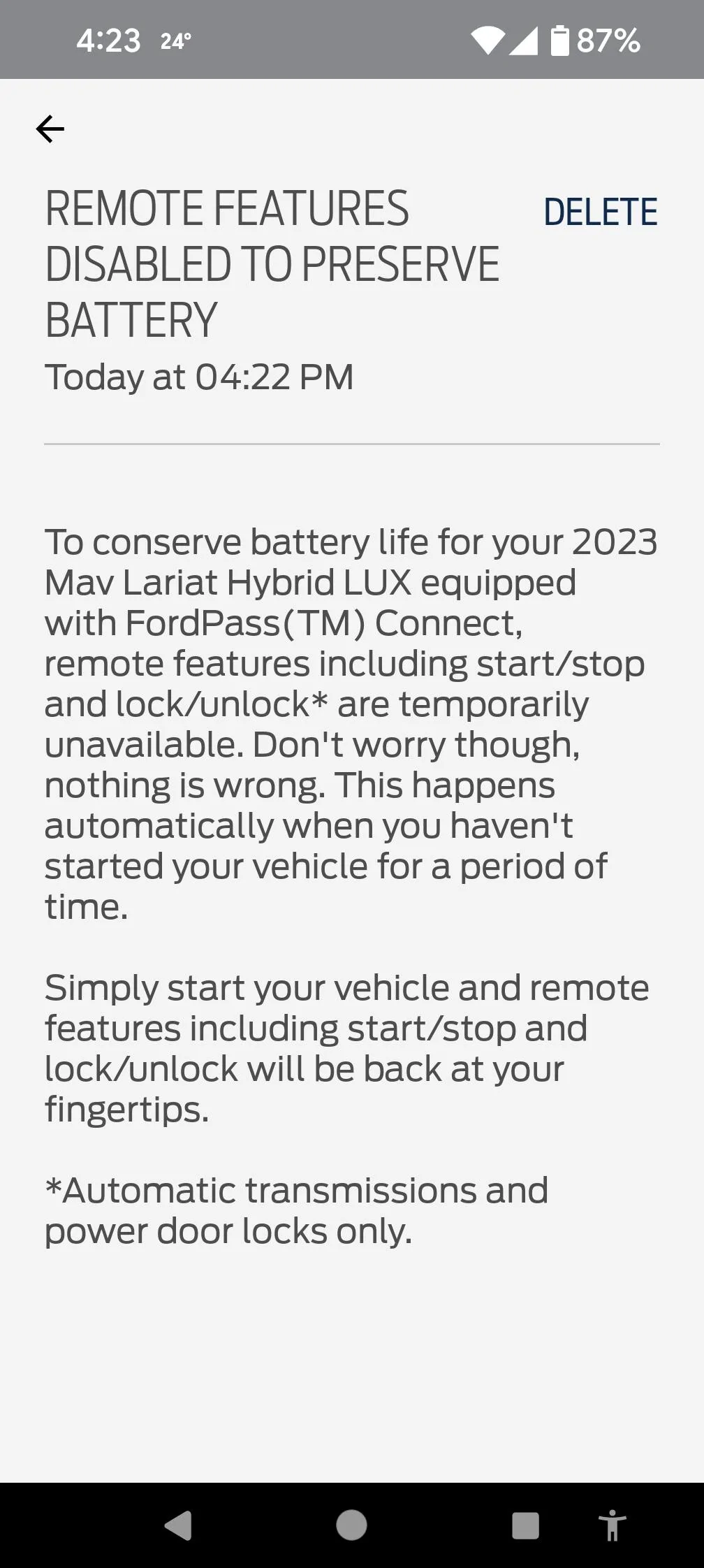

I believe Ford is aware of these 12volt issues and working on a soluion s. I have open case with Ford on this isse with my 2023 Mav Hybrid LUX. In the meantime I am driving more often and using battery tender which is super annoying on a new truck. My battery already changed out by dealer
Truck goes 2 days without driving into battery saver and less than a week for deep sleep, all updates done dealer bench tested battery twice and it has passed.
Fist 6 months it took 2 weeks to go to deep sleep ( sometime I travel on business and drive other vehicle)
Not sure if this is what you guys are seeing but it's super annoying
This issue continues to be a problem with all Mavericks, including the EcoBoost. I have been experiencing the same issue with rapid 12 volt battery drain for the past several months even though my 2023 Maverick Lariat Hybrid is only 7 months old. This type of issue is not only confined to Ford Maverick, other makes and models of Ford have experienced similar issue, even other manufacturers are dealing with it Toyota, Hyundai etc. Ford has opened a case (CAS-46417691-R3M8Z8) on my reports and my dealer here in the Austin, Texas area is cooperative and working to solve the problem. I have taken the Mav in twice, first time dealer replaced battery, but problem quickly returned, now it is a daily issue I must be concerned about with my new Mav, which I really love, except for this problem. If I drive the Mav daily for at least 15 minutes it seems to be okay, but I still get FordPass alert messages, if it sits for more than 2 days, even in the garage, I have to charge or use battery pack to get it started again - totally unacceptable situation.
It is too prevalent for Ford to not be aware of it even if it appears to happen to 10% possibly less. The ones not experiencing the no lights, etc I expect the trucks to be reporting their codes Everytime the trucks are started. Ford I expect to know the 12v SOC of every vehicle model sold. It should be a minor issue to compare deep sleepers to those that never. They should be able to see your 12v SOC an hour after you shut down truck and the SOC when your fob approaches in AM. All that clicking is not for nothing, I am sure of. Therefore they would know when you put your maintainer on. I am somewhat unhappy that I feel the need to top my battery off periodically but with such heavy usage irregardless of battery type or brand LONG BATTERY LIFE REQUIRES IT.
Are they aware ? I'm sure.
Are they working on a fix ? Unlikely as I suspect it would be a heavy software update that would impact a lot, including some EPA recertification (more charge = in theory uses more "fuel")...or heavy physical updates due to bad parts.
Not a good look for @Ford Motor Company
