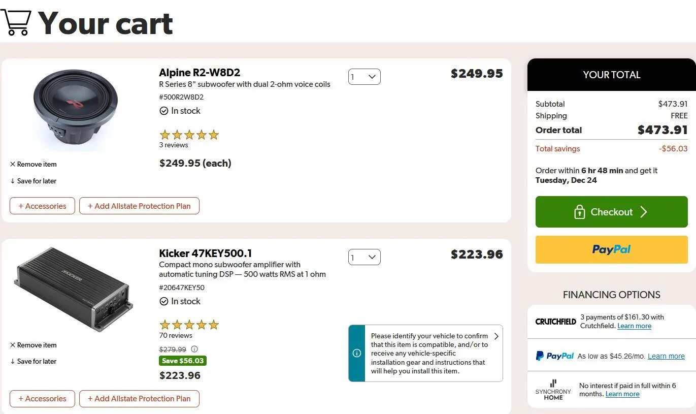

Its a cheap NVX sub and amp.
ah. well, $474 gets you my set up and if you're not happy with it I'd be pretty surprised.
if that isn't in the cards then get the amp because it's on sale and having a powerful amp with dsp is critical. and then it looks like a kicker compR 8" dual 2ohm is $80, so that brings the total down near $300. (this would be overpowered also, but you could run the dual 4 ohm instead if you wanted, also $80.)
