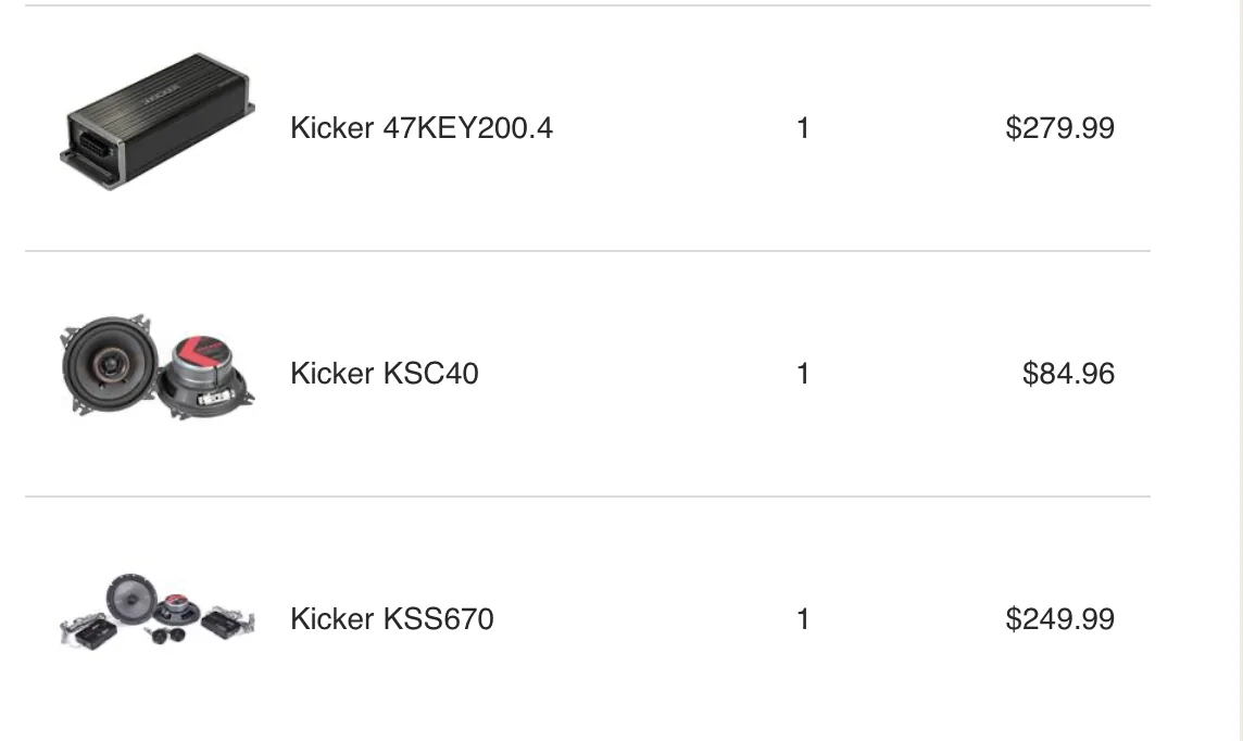

Here's a timely data point...
I've had the kit for a complete audio upgrade sitting around since May. Life got in the way this summer, and I've just now started installing it. I started with the absolute hardest part: the rear speakers. Below is what I put in (Kicker KSC40s), but not pictured are a ton of Tesa tape and lots and lots of sound mat. Audio stuff was from Crutchfield; tape and sound mat etc. were from Amazon.
Ford Maverick Gotta replace the speakers 1757981959358-x5
I just finished the rear speaker install. I put non-continuous sound mat on the back walls of the cab and inside all the plastic trim pieces. Most of the mat will not stop "road noise" from getting through, but it has made a noticeable difference to resonance and random rattles. The back half of the truck is much more sonically "dead."
As far as the speakers themselves, I already think this is a worthy upgrade. As nobbyv said, I'm going to push the soundstage to the front (technically, I'm going to let the Kicker Key DSP do it), but the clarity in the back is already MUCH better... with $85 speakers, no less. A 4" cone isn't going to "thump," but just the fact that they actually HAVE tweeters helps immensely.
TL;DR rear speakers are worth it, if only because you can take all the trim off and improve the background noise levels with sound mat while you're in there.
Full disclosure: I have not done anything to the system EQ with Forscan yet, and the rear speakers took me maybe 8 hours including the sound mat and tape.
Cracking into the front doors next.
