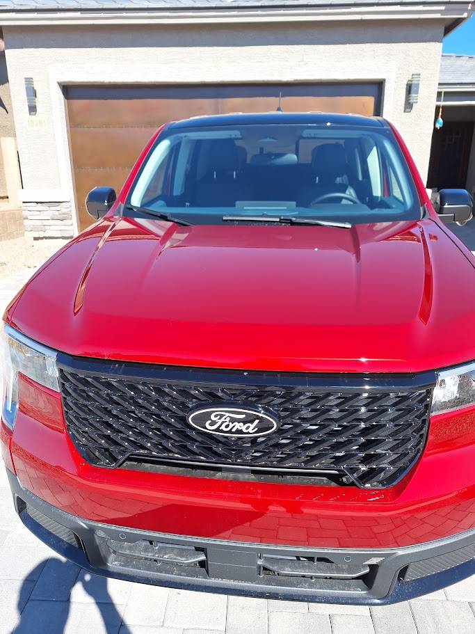

doubt my $20 heat gun is capablle of that, if I decide to try it, will keep it on low
It takes very little heat to pell them off. Think of them as a sticker. It is below freezing here, and just a slight bit of heat made it come right off. Basically just used it to get an edge up and then peeled it off.

Is there chance of the painting coming up when you remove the decals ?
No you're not going to peel the paint off, just park it in the sun for an hour next week when it hits the '80s start lightly peeling the stickers away.

also, I was told to pull backwards, not outwards. like dont pull straight up, but pull it backwards, basically back on itself.

Thanks to all for the good advice, went outside today and surface temp on the hood was 115 and they were pretty easy to pull off,
Looks much better!
