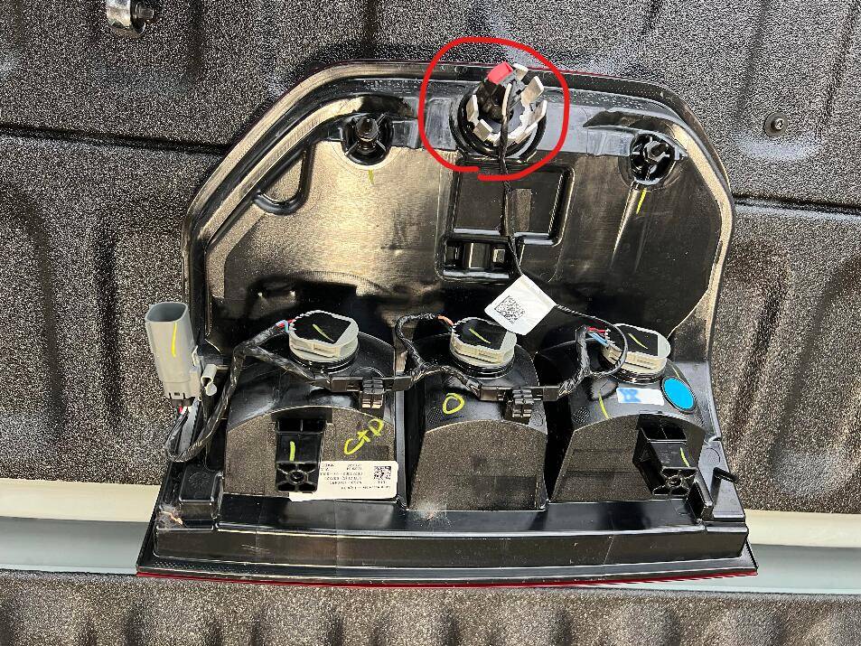

Hey was wondering if you ever did this on your Lariat lights, and if you did, does the same process work without messing with the LED strip?
ZEP won't effect the light pipe. Simply remove the LED module like you would any other bulb.
