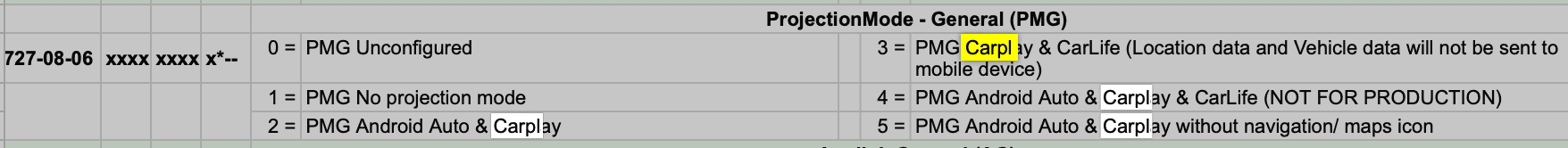

I am going to assume it's something to do with your iPhone maybe CarPlay settings?? Because if it is working for android it should work with CarPlay.

It's never worked on my iphone(spare line) and mine is jailbroken with Carbridge.

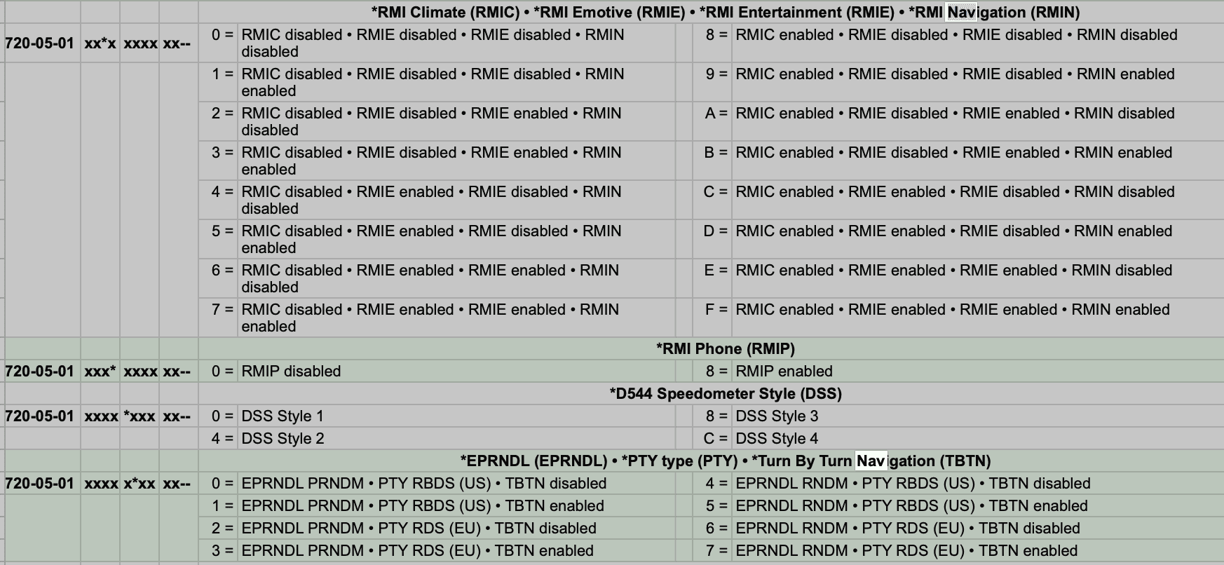

really? hmmm. I wish my XL was a Lariat so I could test this some more and try to figure it out. lol There is this setting for the ACM I have in the picture below. But the Lariat would have that coding in the APIM instead, which I cannot see or view..

Not sure if this coding change would do anything to solve the issue though.
