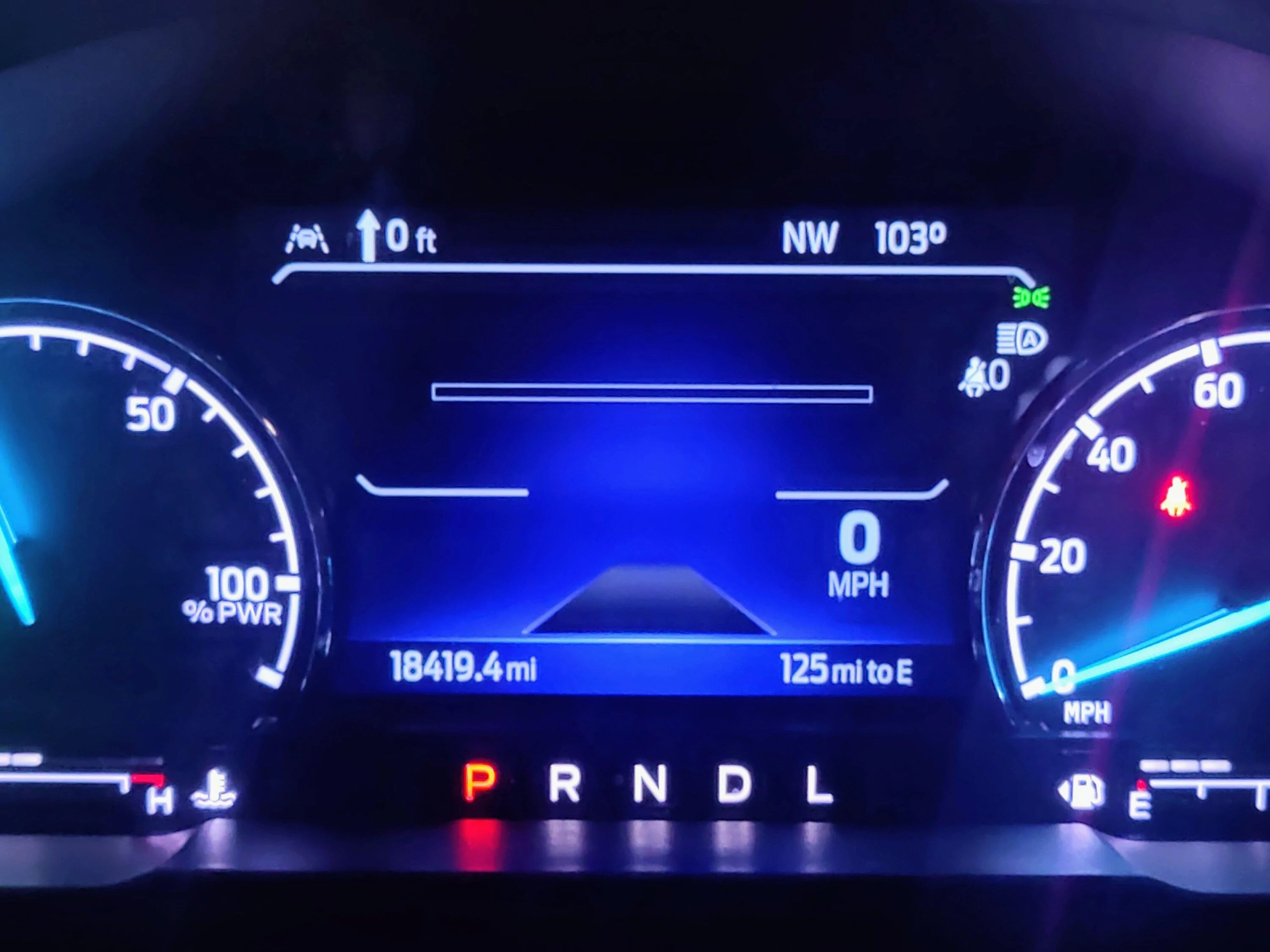

After hours of looking at YouTube, forums, and even reinstalling the drivers to the damn thing, I am still not seeing the APIM when I plug in my OBDLink EX. My laptop has all the necessary qualifications so I'm not sure what the issue is.
However, I have been able to get the Eco Coach and speed limit signs working. But I need access to the APIM to tell it to actually send the turn-by-turn data for the IPC to display.
