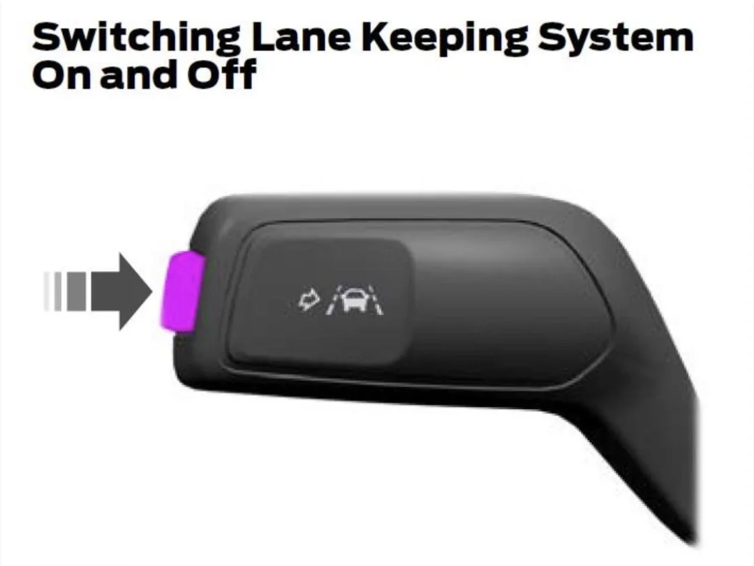

Let's start with the basics? Make sure you didn't accidentally turn it off with the manual button.
Ford Maverick Lane Assistant - appears on the display but not work 1000023341
