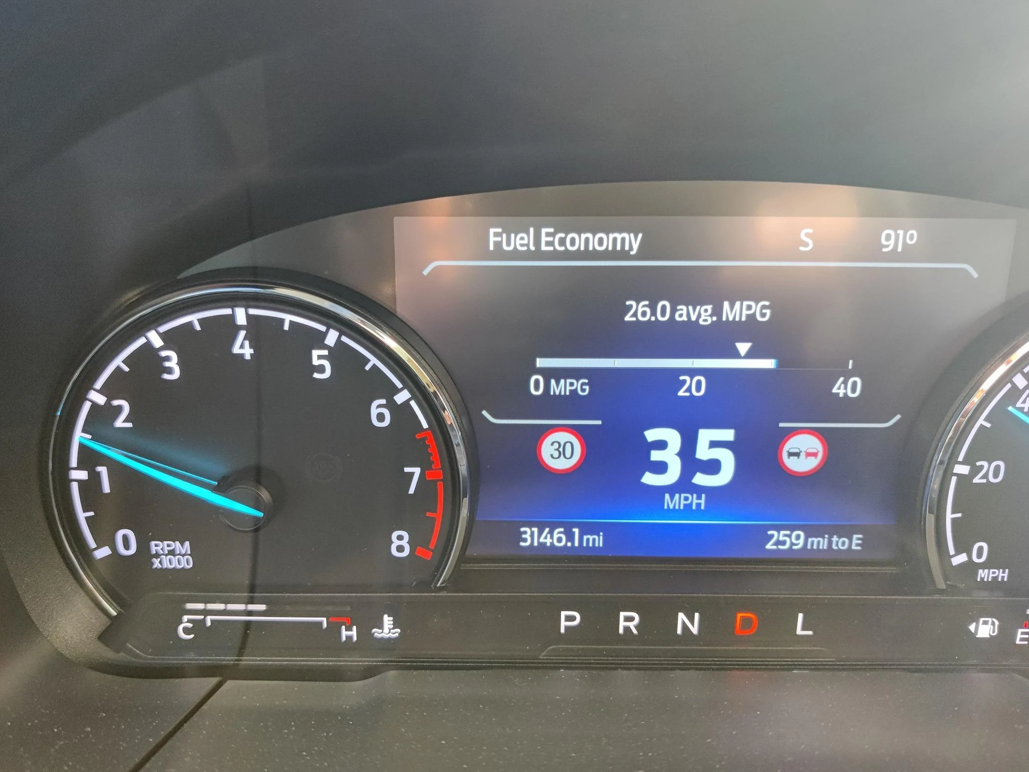

Are round signs really an "error"? I followed the tutorial that gave me the round signs. Yes, they do look European but that didn't bother me enough to try a different method to get the rectangular signs.

Not really an error but I'd sure rather have the square signs displayed. Think I just found the setting in the Ultimate Forscan Spreadsheet! I'll give it a try.

Try leaving Traffic Sign Recognition disabled on the instrument cluster and set to SLIF just on the imaging module. The TSR options should still be available on the IC and enable the functionality with square signs.

OK, I messed around with a few settings and got it more to my liking. White, square speed limit sign on the left side, my actual digital speed on the right. The SL sign flashes to scold me when I'm exceeding the speed by more than my set 5 mph over limit, which is easy to do on these country roads.

Still haven't had any luck making this signs square. Any advice?

From the Ultimate Forscan Spreadsheet. Double check the IPC settings as shown. I'm pretty sure fiddling with enabling/disabling that did it for me. I just don't remember which setting gave me the square speed limit sign.
Traffic Sign Recognition (TSR) EnableIPC(EZ) Enable OR Disable "Traffic Sign Recognition (TSR)"DISABLE on 4in Cluster, ENABLE on 6.5in Cluster, Try Both
IPC(EZ) Enable "Speed Limit Info Function (SLIF)"Disable = European Signs, Enable = USA Signs (4in ONLY)
IPMA(EZ) Change "TSR" to "Speed Limit Info Function (SLIF)"
IPMA(EZ) Change "Traffic Sign Recognition Mode" to Camera Data Only"
TSR MAY DELAY OR INTERFERE WITH PRE COLLISION ASSIST WARNING ON 4 INCH CLUSTERS

Yeah I've tried all that. This seems to be the only combination that works, but the signs are round.
IPC > TSR > enabled
IPC > SLIP > disabled
IPMA > TSR > SLIF
IPMA > Traffic Sign Recognition Mode > Camera Data Only

Try enabling the IPC SLIF for the hell of it. I know it says 4.5" screens only but (save config first) and give it a try.
