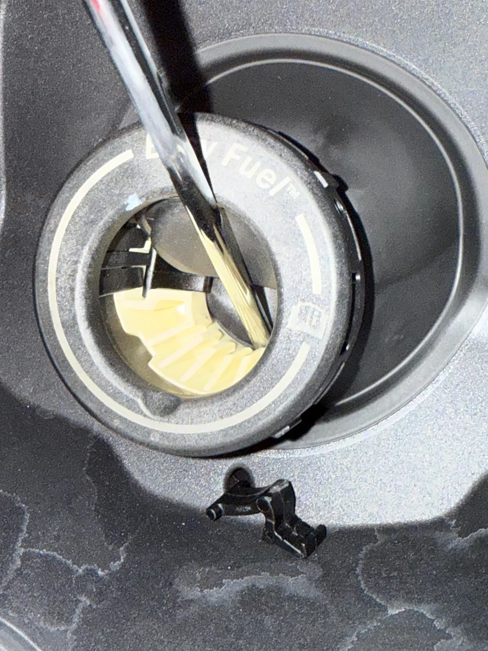

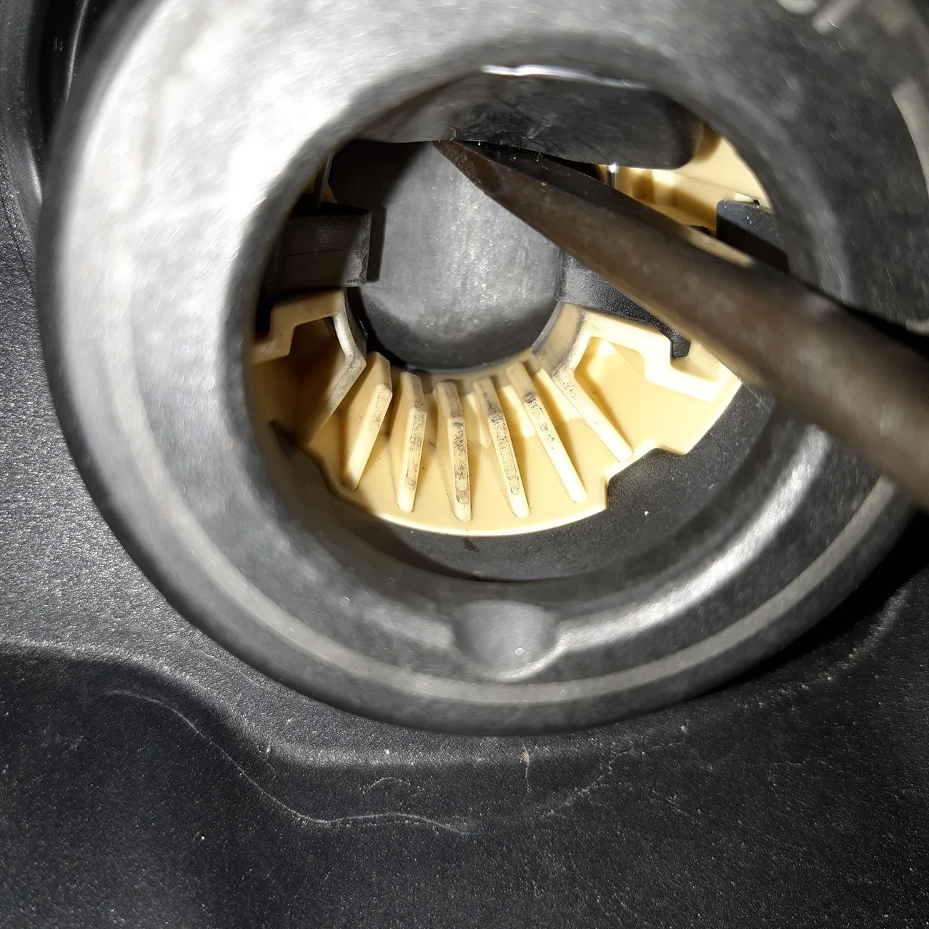

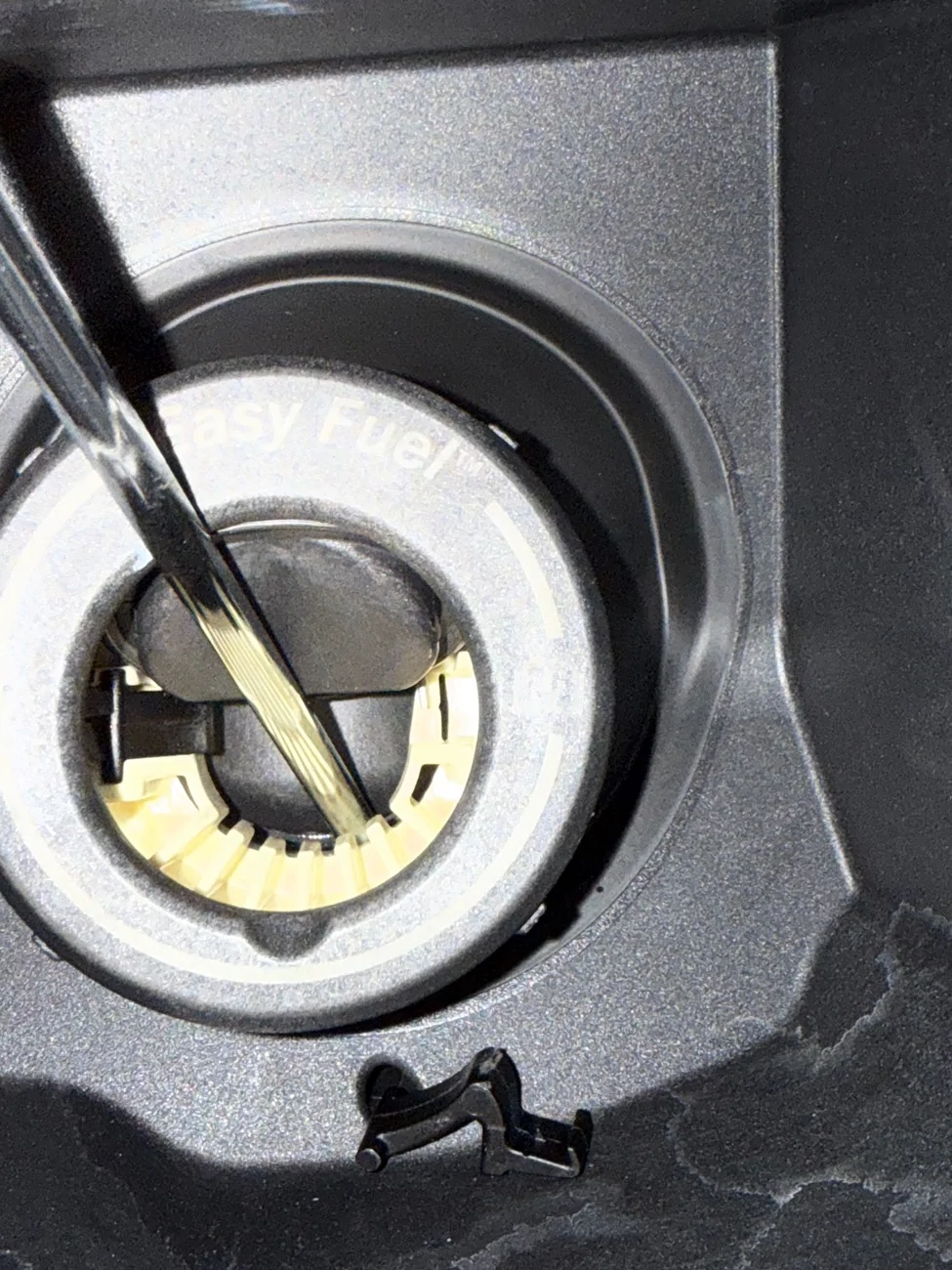

This clip came out after removing the gas nozzle at Costco. There seems to be two of them, one on each side. How how can this be reinserted? Thanks.

Sure a piece didn't break off already from that piece?
The color of that edge facing up sure appears like there used to be more to it.
Which has now gone down the filler tube perhaps.
Hopefully this repair falls under bumper to bumper.
Because potentially to get that smaller piece out...
I don't understand why that's there actually - sure appears it could catch the nozzle on each insertion.
Wondering if it's something to be removed before delivery.

I looked at it this morning. I didn't see a way to reinstall the little black clip/hook. It would really be a pain trying to reinstall it and hold the spring tension flap open.

This should fall under emissions warranty.
"Fuel Filler Door Sensor (Hybrid and Plug-in Hybrid vehicles only)
• Fuel Filler Tube and Seal (non-diesel only)
OP - this is route if you can't put it back.
OP,
After seeing the pic that it is supposed to be there (sure looks flimsy for taking a hit from the metal nozzle), it sure appears you could place it back.
My comment on area that appears to have a break off, can't be - that's a wear point, can't stick out further.
Now the back side still could have a broken off piece that pops in - but sure appears you merely need to slide the side posts into a slot, and push the bottom bend around the edge of the white plastic.
The hook appears to let that next flap push down, or come back up and be held in place.
