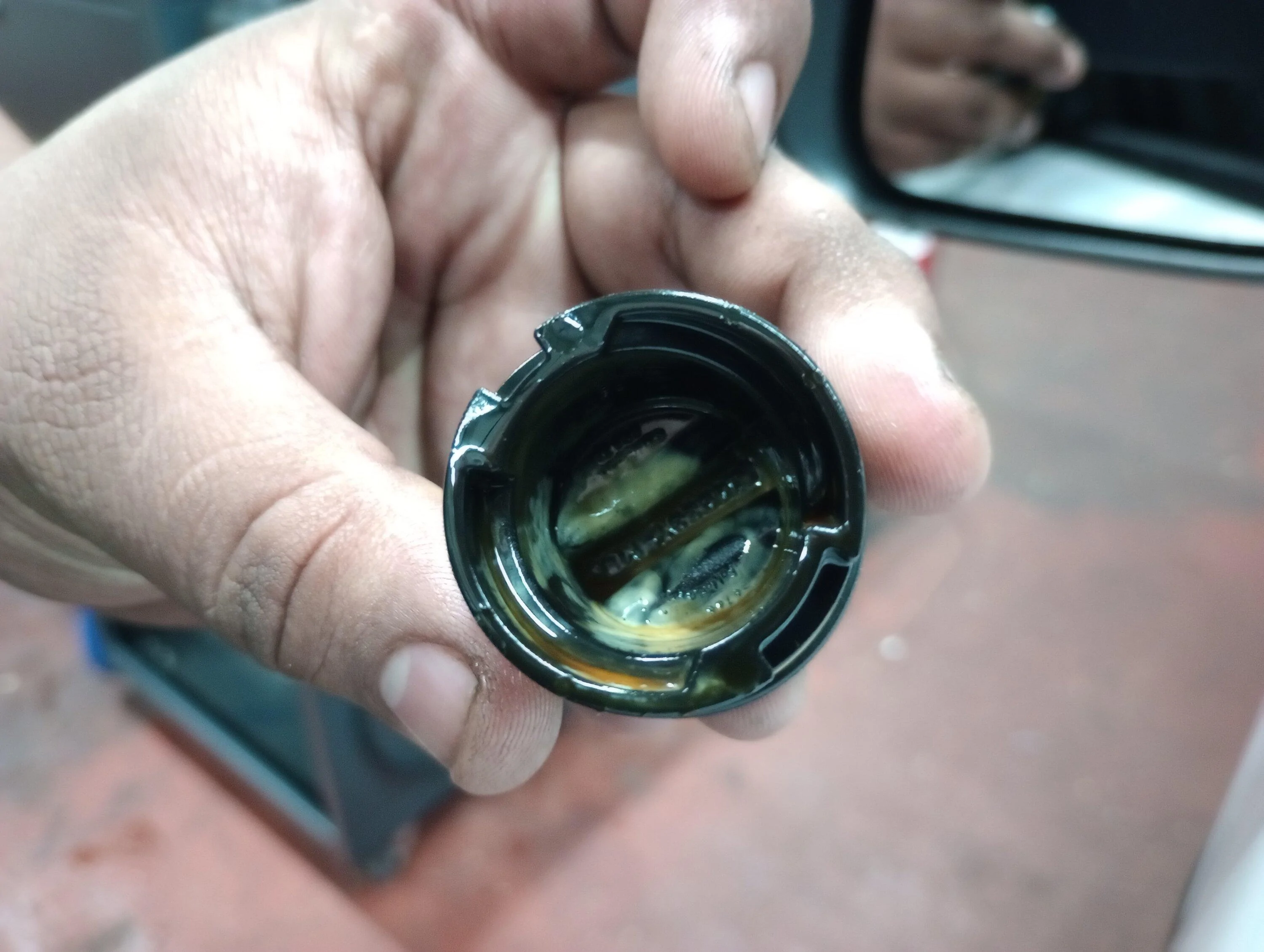

Go look at your dipstick, like Bad Actor said above. If not milky on dipstick you are good. You could check coolant and see if it is milky. Can leak both ways.

Got oil change today... The tech showed me the cap and it looks like this. Anyone know why?
A Ford tech? He just showed it to you and gave no explanation? Lousy tech. Short tripping. Stop the short tripping.

Nah... It was an oil change tech. He recommended having dealer check it out.
