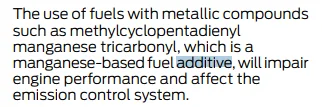

A quick look thru the owner's manual only says don't use
Ford Maverick Gas additives safe for 2.0 Ecoboost? Heet / Seafoam 1672081711027
It specifically says to NOT use any oil additives.
