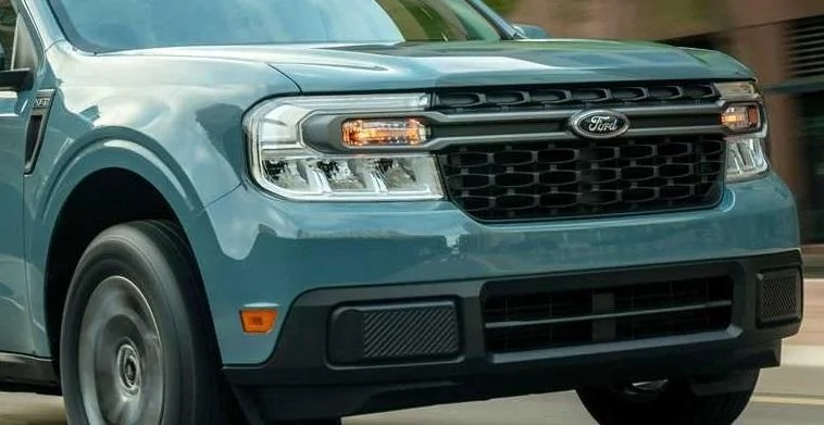

The one downside that I see on Ford's part is not making the cover where the tow hooks go a detachable piece. It's hard to believe that the design team didn't think that people would be mounting tow hooks or (and especially) fog lights! Sure it might not be that hard to cut out the piece, but it would've a whole lot easier if it was a pop-out panel.

Does it look like the lower bumper from the FX4 would fit on your non FX4 to be able to install fog lamps or driving lights in the opening.

How would people cut the hole in the bumpers for fog lights without it looking like a diy project? For me fog lights are more useful than tow hooks...
I'm guessing it'd be the same way folks trim plastic bumpers on Tacomas, 4Runners, and Frontiers...with a die grinder and a cutoff wheel, steady hands, and some fender trim to cover the edge.
Perhaps a good mount for aftermarket fog lights.
Those two holes (where those 12mm bolts for the tow hooks to go through) look like perfect candidates to hang a bracket that could be used to mount cube lights, similar to how folks put cube lights in the not-intended-for-fog-lights holes in the F-150 SVT Raptor's bumper. Maybe even some 6" double-row light bars will fit.

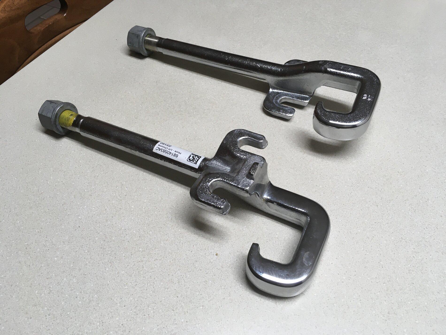

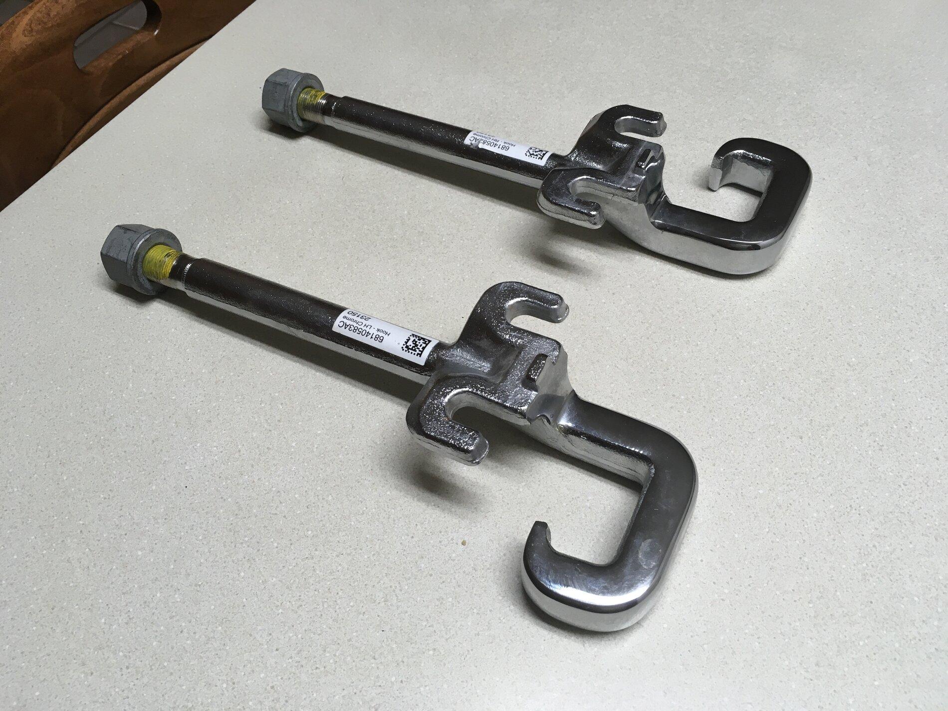

Now seeing that the rear tow hook support brackets are not installed on EVERY Maverick is an indication that there are probably other chassis modifications for the FX/4 package only. If there is a true desire for installing tow hooks, I would suggest that you just get a fabrication shop to make a pair of brackets that you can bolt on the frame.
Below is a pair of tow hooks off of a 2021 Grand Cherokee. They were removed when a flat tow base plate was installed. If you notice the same long shaft and nut at the rear that allows for front bumper compression in the event of a crash.

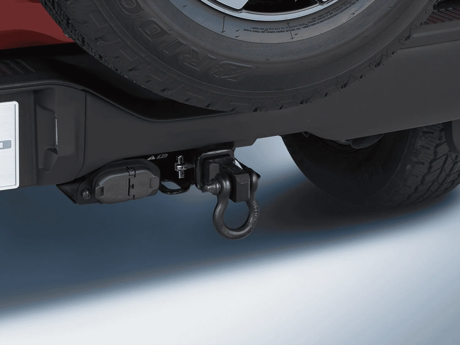

Unless you are going in the ditch backwards, you can always use:

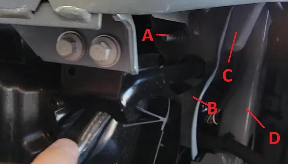

Well I don't know how far the OP, Mrboom is willing to go helping with this, but I have made a diagram which may show how this problem can be solved.
Bolt (A) holds or bolts frame/parts (B) and (C) together.
Are parts (B) and (D) in this diagram the same part, attached or welded together somewhere as to be connected?
A hook could be easily fabricated to use the existing factory two 12mm bolts up front and the rear attachment point could be BOLT (A). It looks like a very strong anchoring point. How strong is the point that bolt (A) holds together?
This would allow a modified hook to be bolted on without welding the frame. It may still not be as strong as a factory FX4 but it could allow a strong 3rd mounting point without welding and get the job done.
Any thoughts Mrboom? Does this make sense?
