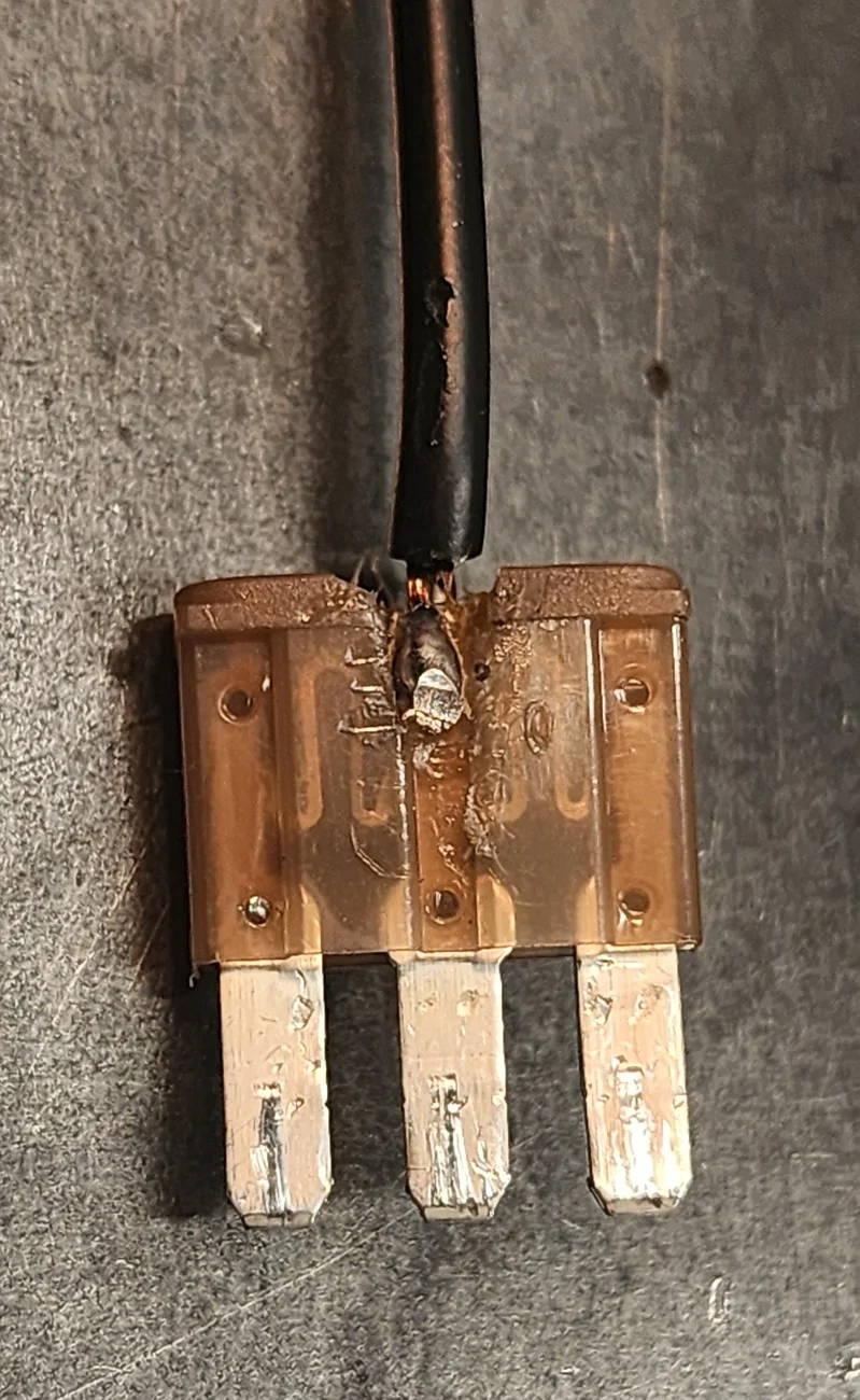

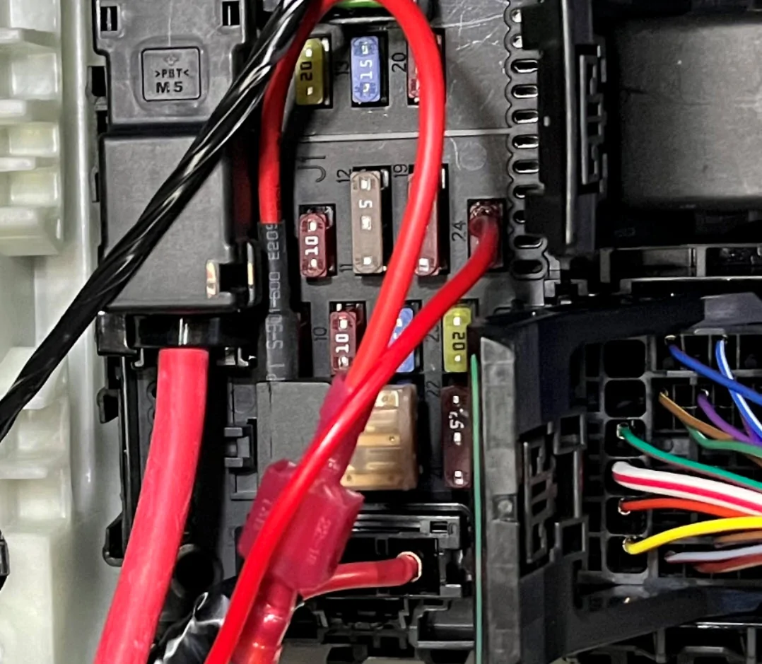

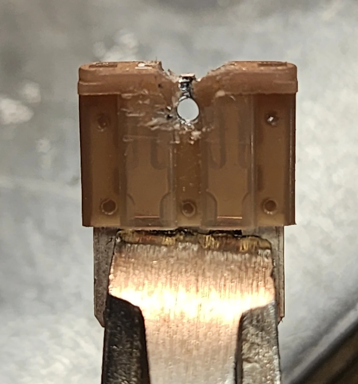

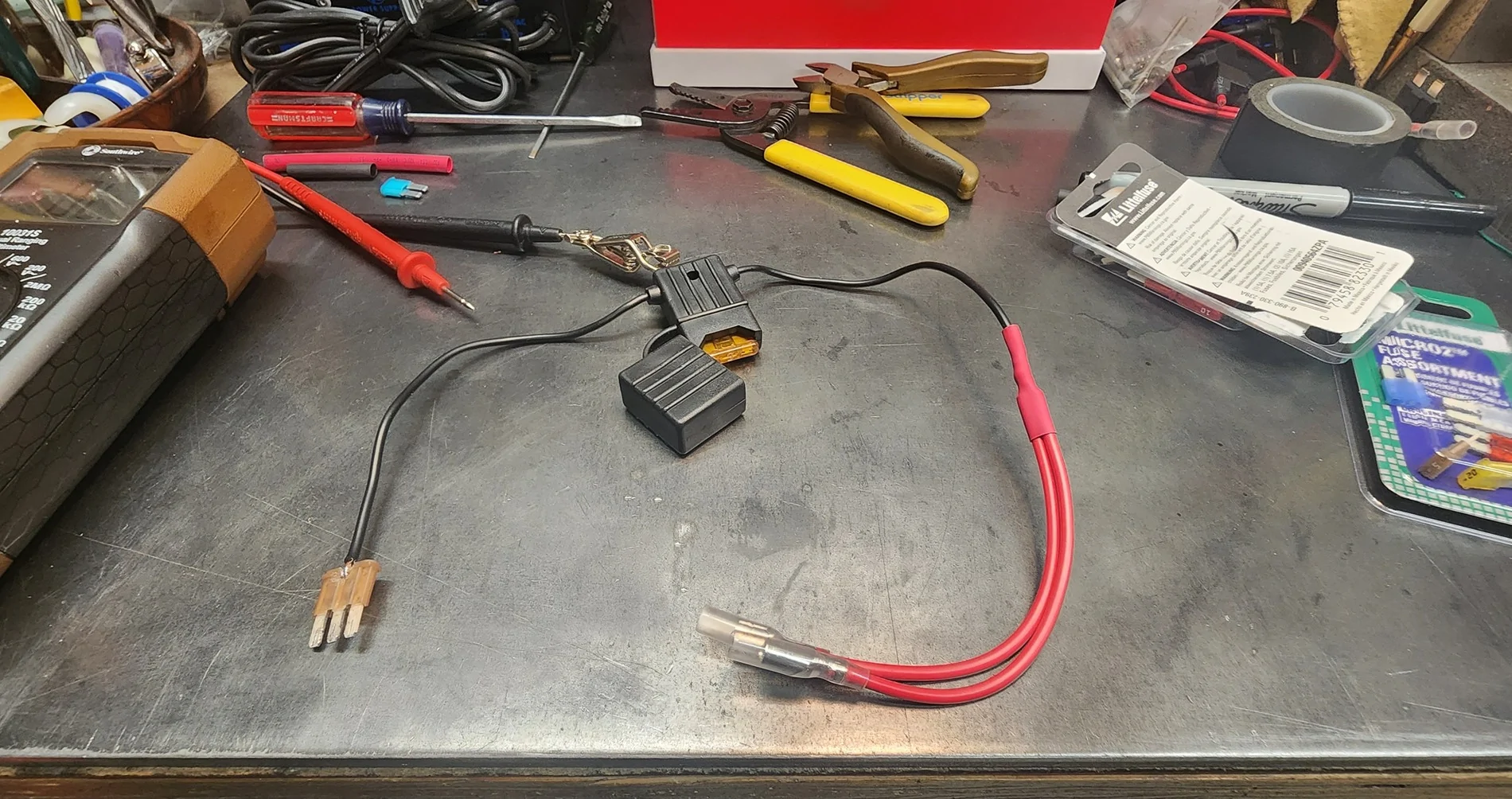

OK, because patience is not one of my strong suits (I'm lying, but I am one of those who say, "Hey, I can always find an alternative to waiting") I just threw this together to get me down the road. Micro3 fuse - tapped. Had to add an in-line fuse holder and added the two wires for the camera. It'll get 'er dun. The micro3 fuse is still intact, though they feed nothing. Going to apply some liquid electrical tape to the solder joint and put it in.
