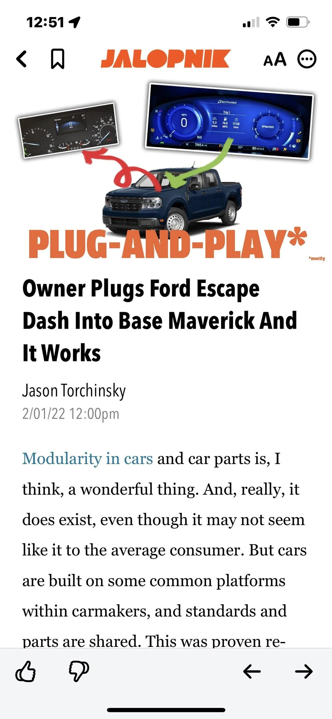

Next is get wiring diagrams for both clusters. Find the epprom chip that holds the odometer readings on both. If they are the same chip it should a simple desolder each, swap and resolder though I'd recommend first checking the hex codes codes on each using a pic programmer so you can check they match exactly except for the lines of hex code that is the actual odometer reading. PonyProg is a free program that you can use to do this. I'd also recommend soldering in a chip socket into the cluster to plug the chip back in.
http://www.lancos.com/prog.html

It should be straight forward if he using something like an xtool scanner that epprom programming functionality.

Also if you plan to do lots of modding on this and other vehicles an Xtool D7 scanner is the way to go on a budget if you want to spend about $500. That tool will also program odometers. Just verify it will work with Mavericks.

Nothing happens since the mavericks come with the L button. I'm hoping once I swap the shifter that the M will light up in the instrument panel and then everything will be connected along with my paddles and I'll be banging gears
But will you know what gear you are in? Will that be displayed on the new instrument panel?

outstanding ingenuity this is one of the most clever component swaps ever

Damn you XL buyers are cheap af but I gotta give you guys some credit. A lot of you XL owners are willing to tear right into your new Mav and do both physical modifications like this and software modifications through programs like Forscan.
Ford Maverick Full digital gauge cluster from Ford Escape swap into Maverick lying-comin
However, it is awesome to see what you guys are coming up with.
