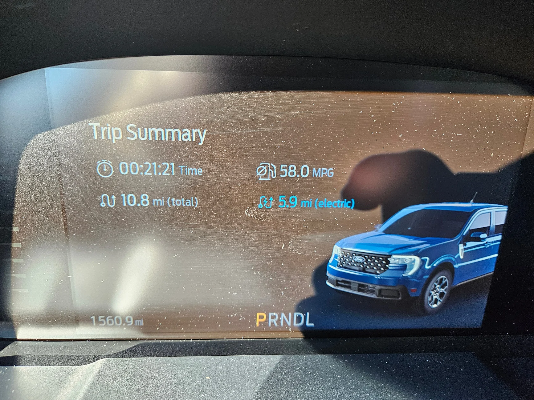

Please do not take this as a criticism or a knock on hybrids. I initially was shopping for a hybrid but changed my mind for various reasons. In the top picture the total miles is 10.8 and electric is 5.9. That leaves 4.9 as ICE miles. Total MPG is 58 mpg but is it actually 58 mpg for the ICE or is the computer dividing gas used by total miles? I fit is total miles then the ICE is actually using the equivalent of gas for 11 mpg. I am just trying to understand how the numbers work. Thanks if you can help me with it.
It's just distance traveled divided by fuel consumed. On a VERY SHORT trip of only a couple of miles the results can be skewed super high or super low. Ir I start the trip when the hybrid battery is just about to start the engine, and the engine is running for most of the trip, it will be absurdly low because the freshly started engine will be running for most of that distance. But if I start when the engine just shut off when the battery was fully charged, it will be absurdly High because the engine will only run for a very short portion of that different. So those numbers are strictly entertainment in my opinion . But as the trip becomes longer and the driving is very moderate I'll get an excellent number. Example: if I drive the 8 miles from my house to my mother's House at 45 mph. I'll easily exceed the EPA rated 40 mpg, perhaps approaching 50 because the vehicle will be running on electric a good portion of those miles. On the other hand if I'm driving a steady 75mph, I might get 33 or so. Of course the Engine is running almost all the time. Again mpg is factoring total distance vs fuel burned. At the end of the day I'm enjoying the fact that under most conditions, the amount of fuel I'm putting in the tank is a lot less than it would be if I was driving the EcoBoost. The only time it is close is under highway driving at relatively high speeds.
The exact same trip in sport mode (ICE runs anytime the vehicle is moving, battery supplements acceleration) I'll see 32-38MPG.
