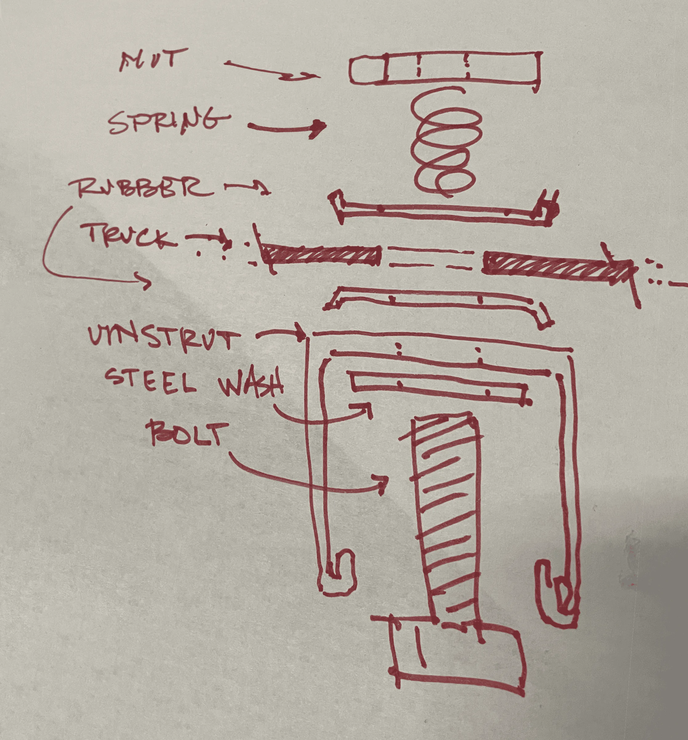

it was an easy job after i figured out the parts,
the spare hardware store part i had already - had to cut with a wheel and paint...
https://www.homedepot.com/p/Superst...hannel-Silver-Galvanized-ZA12HS10EG/202714274
and one of these for up inside the hole (part of the same unistrut system - the spring is the best part because you leave that dangling though the hole below to give you something to hold onto when threading the bolt, there is no access from above...
https://www.homedepot.com/p/Superst...nel-Spring-Nut-5-Pack-ZA1003-8EG-10/100179881
https://www.homedepot.com/p/Superst...r-Galvanized-5-Pack-ZE142121516EG10/202077369
i used a couple of spare rubber washers i had for above and below the hole to cushion the paint
you'll probably also want a washer inside the strut to keep it steadY
and for real car parts i used this...
https://www.4wheelparts.com//p/westin-license-plate-relocator-kit-32-0055/_/R-BCTC-32-0055
and this part i suppose is optional...
https://www.oreillyauto.com/detail/c/dorman-help/dorman-help-license-plate-bracket/mtm0/68148?q=Dorman+HELP!+Dorman+HELP!+License+Plate+Bracket+|+MTM+68148&pos=0

^^ here you go
i should also mention, prior to tightening, there is fair amount of leeway in the pivoting so you have some options for positioning angle.
assembly went something like this...

For anyone interested in both not getting tickets (if the case in your state) and also not drilling, i cut a piece of unistrut and mounted my front plate from the undercarriage, making use of the winching hole, going for a similar "offset" theme as the rear...

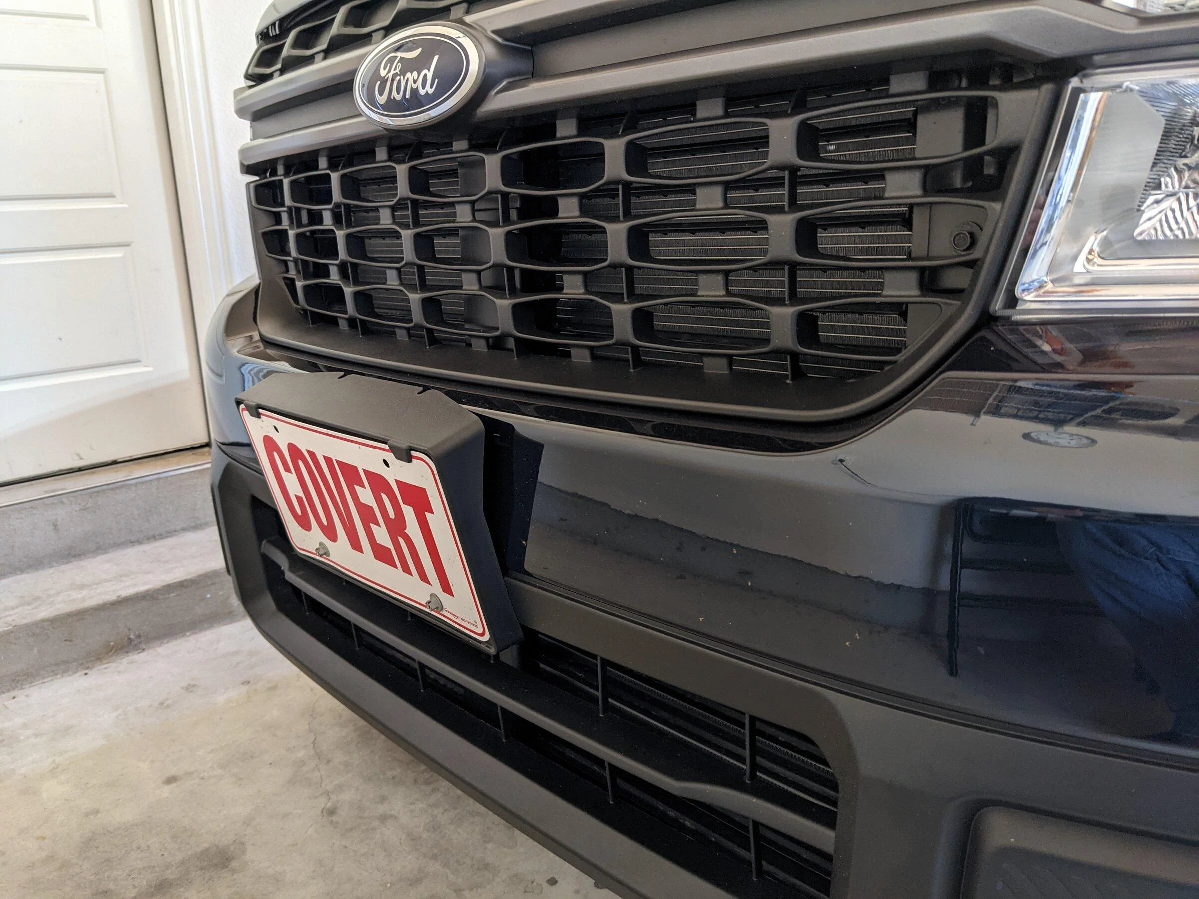

I must be in the minority. I live in DE and the front plate isn't required. But... I wanted the front plate holder. My dealer didn't install it right there, and I didn't want to wait for them to install it since I was running late to a dinner get together with friends on the day I picked it up. The drilling part of the install was easy, the bottom two drill holes are actually in dimples. But the plastic clips were annoying to use. They were essentially plastic pop-rivets so you have to pull the shaft out while holding the body in place. My pop-rivet gun is for metal pop-rivets so it didn't have a nozzle piece large enough for the plastic shaft. I had to hold the rivet body in place with channel-locks in one hand, and grab and pull the shaft with pliers in my other hand. I wasn't able to fully pull them to snap the shaft so I had to then cut the shaft off with heavy wire cutters. What a pain in the butt.
The reason I wanted the front plate holder even though my state doesn't require a front license plate was for a vanity name plate for my truck:
Ford Maverick Front License Plate or No Front License Plate? PXL_20230805_191511796
For those of you who are stuck with the front plate holder installed and you don't think you need it, this is an idea instead of trying to cover the holes drilled into your bumper. YMMV

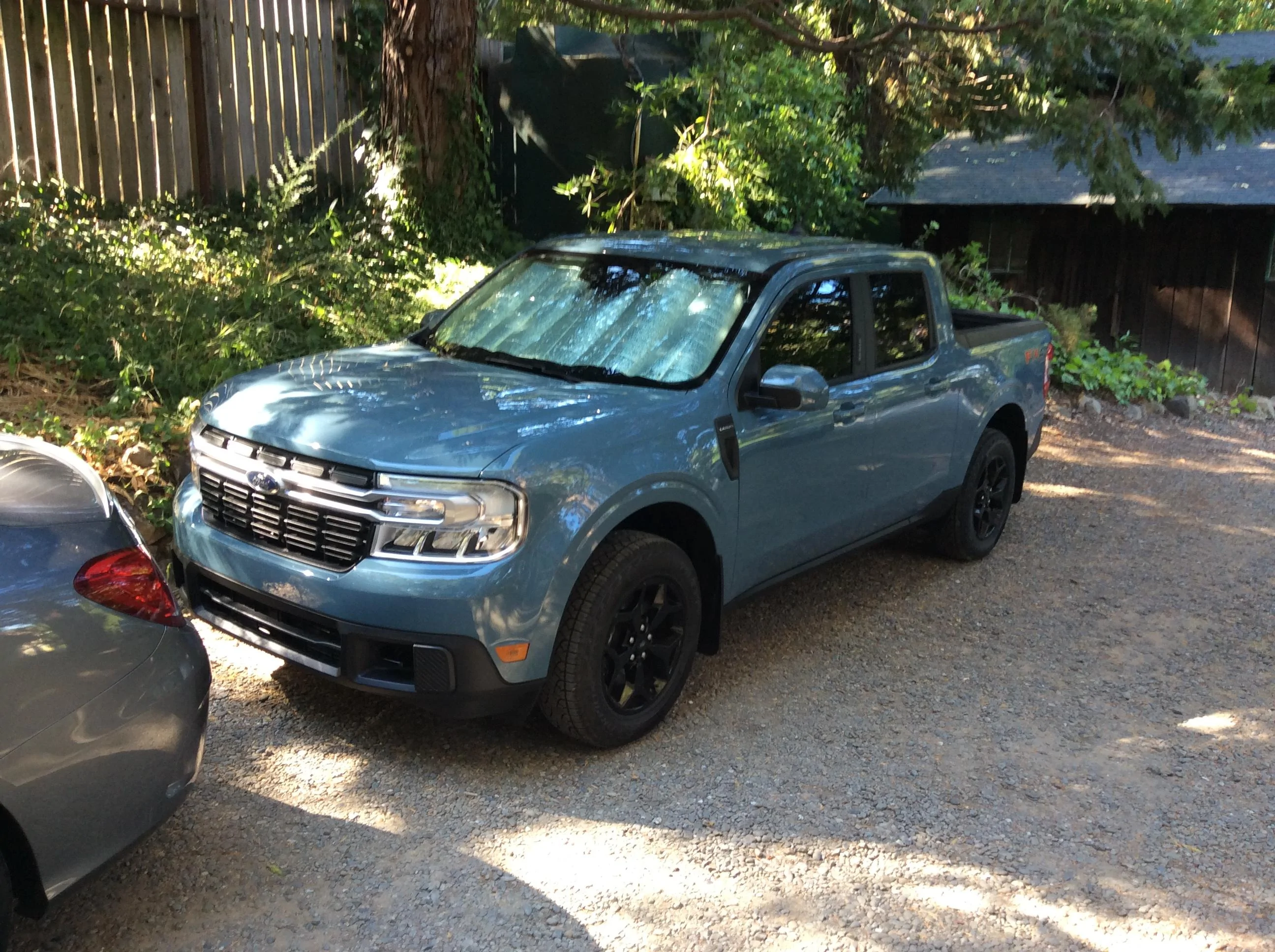

I asked my rep please don’t drill my bumper, he said...maybe. Lucked out I think it looks clean. my plate is under the back seat with tie wraps if needed. Then There’s that yeah, whole constrained part story, waiting for the dealer to send the plate mount. šŸ˜‰ However just for drill and reasons mentioned, both kids and wife run front plates.
