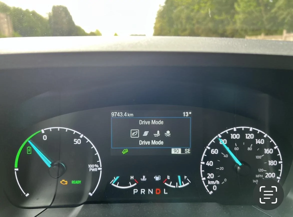

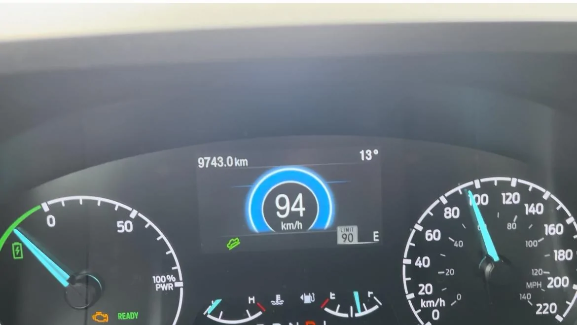

After you removed the other modes, did the leaf show when you pressed the mode button?
The Eco mode animation being the one that shows when you press the mode button isn't definitive. Does it show the leaf icon when on the main screen all the time? Or a better test would be set your cruise control, slow about 3-5 mph, and resume. Does it gradually accelerate or does it jump on the throttle? That's the better tell if you're in Eco mode. The CC response is the main reason I use Eco since I otherwise get the more regen from L. And when I tried the 'just delete the other drive modes in ABS' it was still obviously in normal mode from that test even though the mode select animation showed Eco.

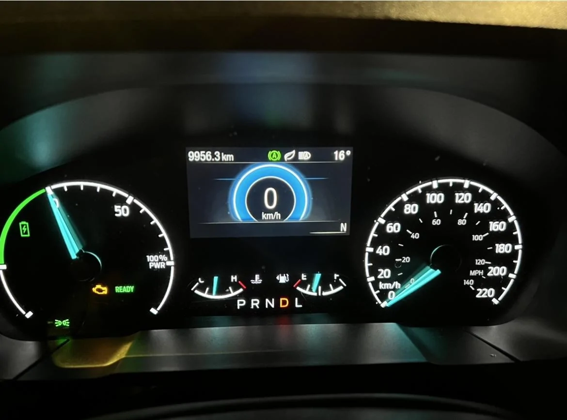

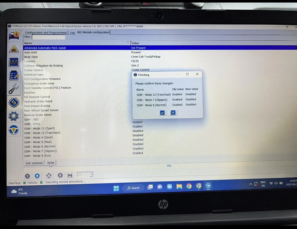

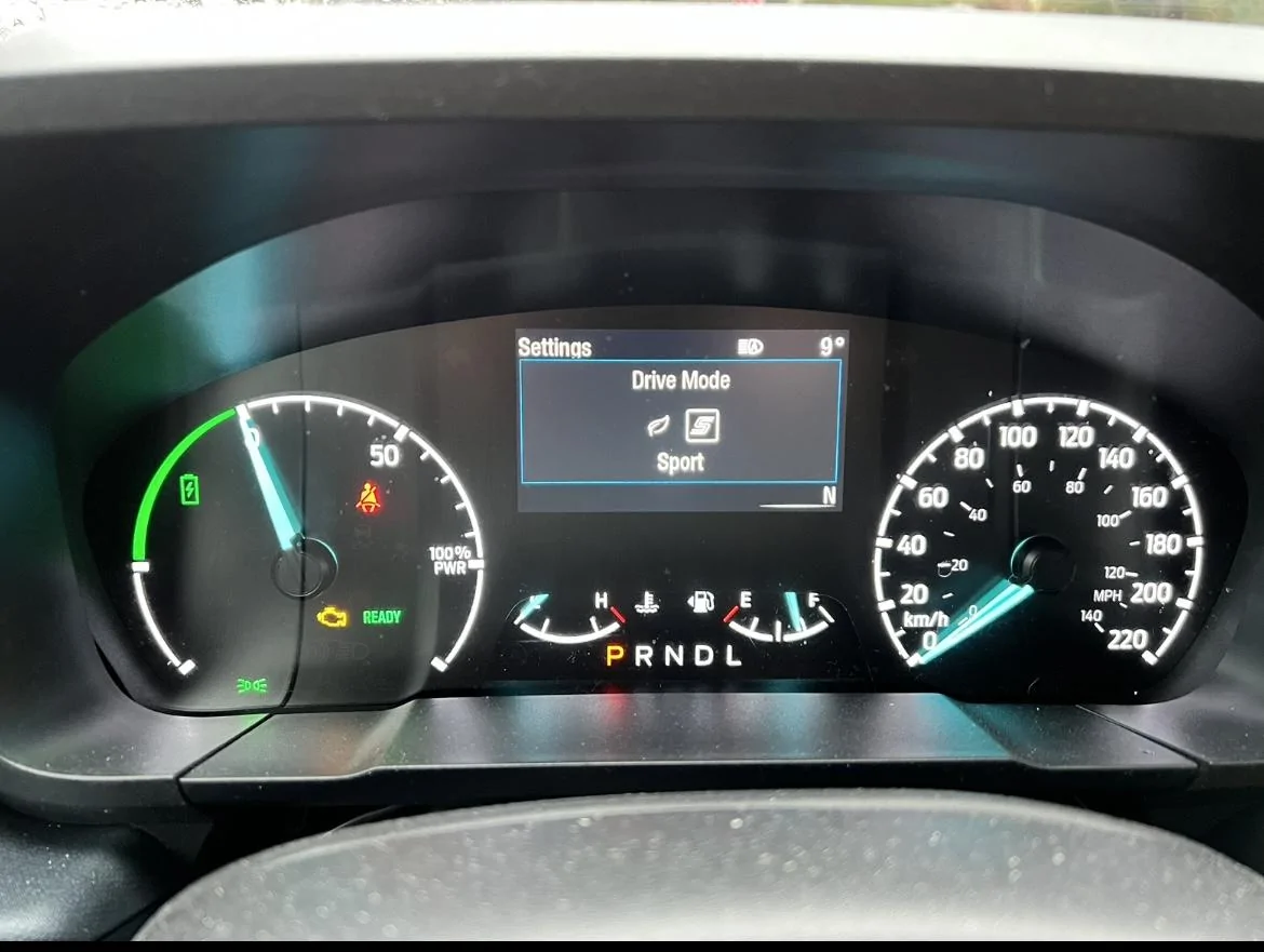

I removed Normal and some other modes using Forscan.
For two weeks I was able to start in Eco mode, the leaf did not appear so I was never sure that it was really in Eco.
After I reverted back to a stock the leaf was visible again.
Can you share how you accomplished what you did.
1st picture - after removing other modes
2nd picture - driving in Eco
3rd picture - back to stock
There has to be a way
Why is your digital speed indicator in blue?
ryan2366
Ryan
Feb 22, 2022
335
356
Canada
2025 Maverick Lariat - Hybrid AWD
Yup Eco coach mode. Basically the bar version wrapped around the digital speedometer.
Changes with your acceleration indicating dependency on gas and reduction of electricity usage.
Yes. That’s what the 3rd picture is illustrating.
Don’t get me wrong, I hope Ponchsox does have it working as I thought I did to. I attached the link where I posted I thought I had success
https://www.mavericktruckclub.com/f...to-eco-mode-with-this-diy-module.17805/page-4
Others tried what I had done and reported back they felt the vehicle was just operating in normal.
Made me doubt that it was actually in Eco mode. Someone with one of those digital monitors that reads everything would probably be able to tell.
The general thought was that if Normal was disabled from the modes it automatically defaulted to it regardless. Nothing to confirm either way.
If someone with one of those devices reported back it was working I’d go right back to how I had it set up.
I just really want it to be in Eco mode so reverted back to manually selecting it until someone else could confirm.
