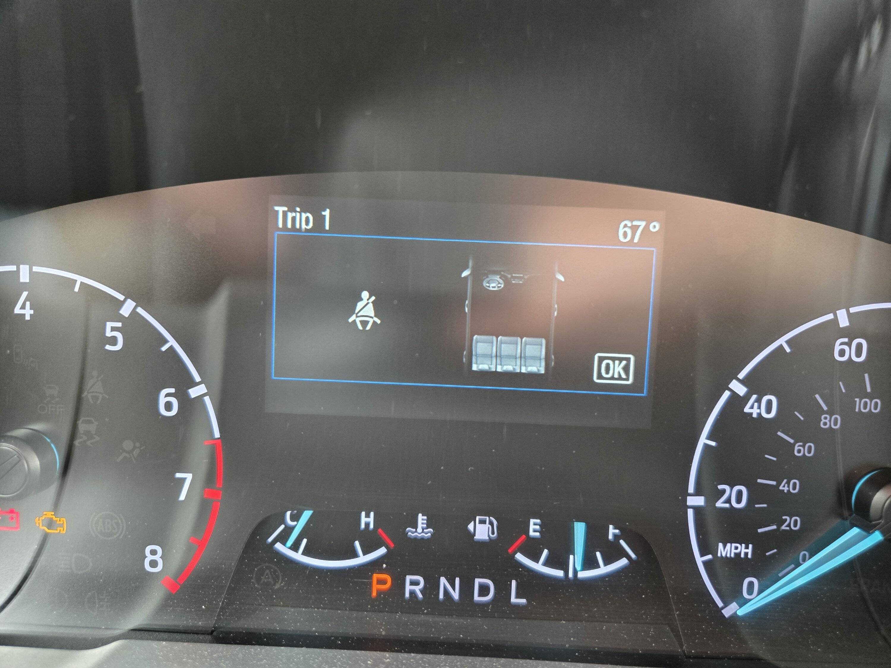

I used Forscan to attempt to disable auto start/start and the seat belt menu. I followed instructions here using various posts and the Forscan guide. The ASS button is disabled but it still stops at lights. The seat belt menu looks like the pic attached. I tried to reload as built for the IPC but didn't fix anything. How can I correct these problems? I used a Vlinker adaptor.

Based on the picture, looks like you told it you had no front seats.

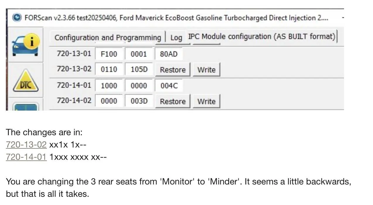

You need to post your before and after numbers for us to help you.
720-13-01
720-13-02
720-14-01
720-14-02
I didn’t get rid of all seats, I just made changes so the screen goes from away as soon as the last seat is buckled. To do I changed the 3 rear values from ‘2’ to ‘1’.
