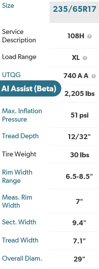

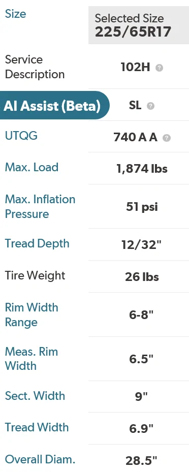

According to Tire Rack looking at a Continental CrossContact LX25 tire (available in both 225-65R17 and 235-65R17 and used only to compare diameter as both are the same tire) the 225 clocks in at 28.5 inches overall diameter vs the 235 which checks in at 29 inches overall diameter.
Right, wider tire but the same aspect ratio means larger diameter. OP didn’t mention an aspect ratio. Could have been 235/60-17 which is a smaller overall diameter tire.
70mph on the speedo means 71.2mph actual speed.
