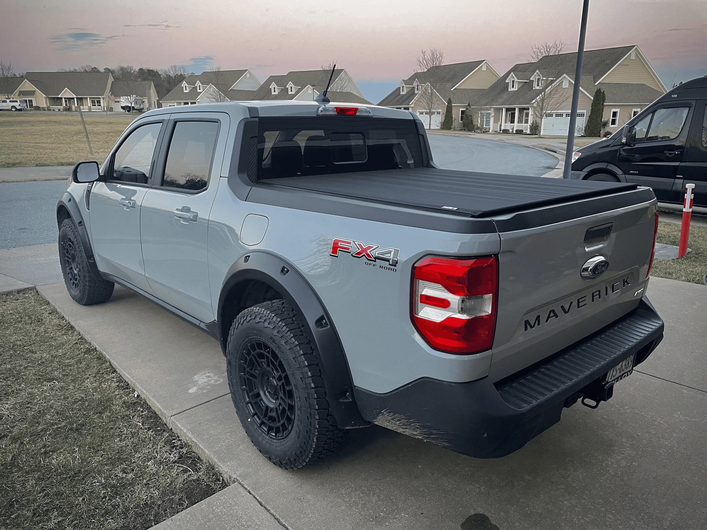

What exactly are you looking for? There are several examples on here of folks with Bushwacker "wide" fender flares. None of them truly need the flares in my opinion.
You could stuff a 255/65R17 on stock wheels, but even that size/width will not necessitate Bushwacker fender flares. Those "wide" flares add about 2" of coverage. You're going to need more than just a wider wheel and tire to actually need that coverage. Either a wheel with a lot less offset, or wheel spacers to bring the tire/wheel out flush with the flares.
I'm all for the wider tire, love that look, but those flares just do not work on the Maverick. If you manage to go wider tire and get it out flush with the flares, good luck turning. You'll need to cut A LOT to get full turning back. Unless you throw on a super short but yet wide tire, then it may work out, but still look quite odd.
This post here is the only one I've seen to actually make the flares look good. And that's because he's running wheel spacers. Bushwhacker pocket fender flares | MaverickTruckClub - 2022+ Ford Maverick Pickup Forum, News, Owners, Discussions

The only way they look good is if you use wheel spacers to bring your wheels out flush with the end of the spacer. 2” spacer in rear, 1” spacer in front.
