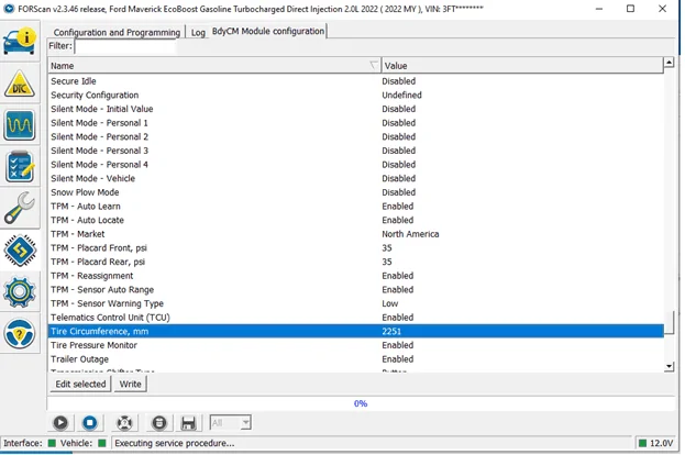

I'm watching this as I'm interested in whether it's worth it to update my configuration to match my newly installed wildpeaks.
The tire circumference value, as delivered, stored in my BdyCM module for the factory installed 225/65R17 A/S tires is 2251mm (a 1% difference).

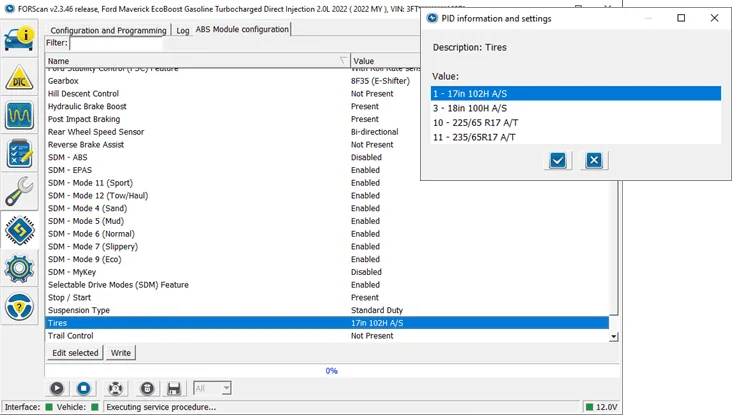

Peeking into the ABS module, and looking at the selectable tire sizes, there are 4 to choose from and match the different tires offered. Does the circumference stored in the BdyCM module have to be close to the calculated values for the selectable tire size?

2251 mm is the same diameter on mine also according to forscan. It could also be due to how the MPG is calculated by the computer not just an average circumference size based upon the no to max tire tread wear.
