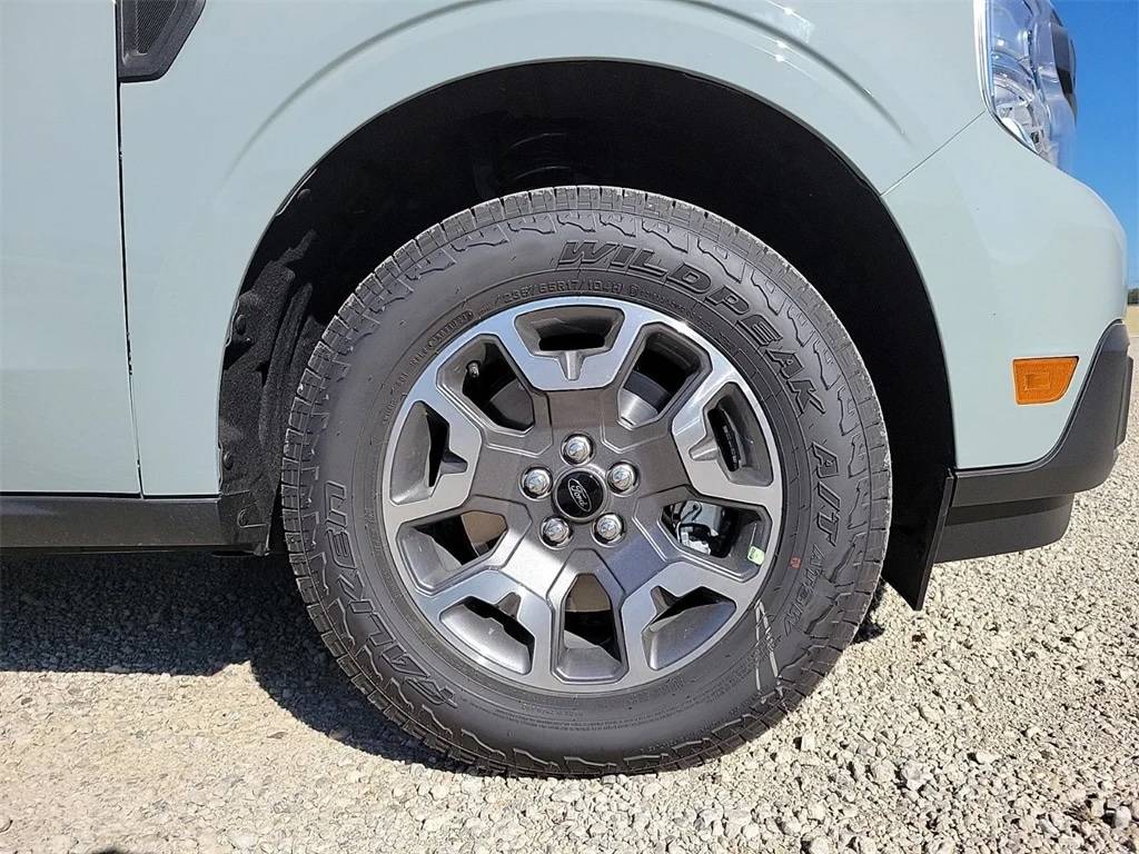

I’m in the same boat, been looking at the Wildpeak A/T and want them as big as the truck can fit. I found a thread talking about tire sizes here and what’s been confirmed to fit by other users, I’ll try to find it and link it here if I can.

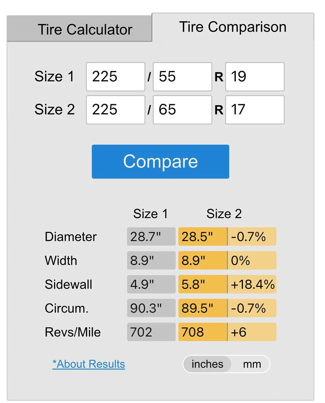

I am running 235/60/18s and my speedometer is closer to Rader indicated speeds now.
Cherokee
Jan 3, 2025
51
3,797
7,191
That’s the width I put on my 21 Bronco sport and I’ll use that size on this 24 Eco AWD.
Add’s about a half inch in width and not quite a half inch in height.
Like you said, closer to actual speed indicated.

I'm running these at 235/65-17. My understanding is 245's will fit.
