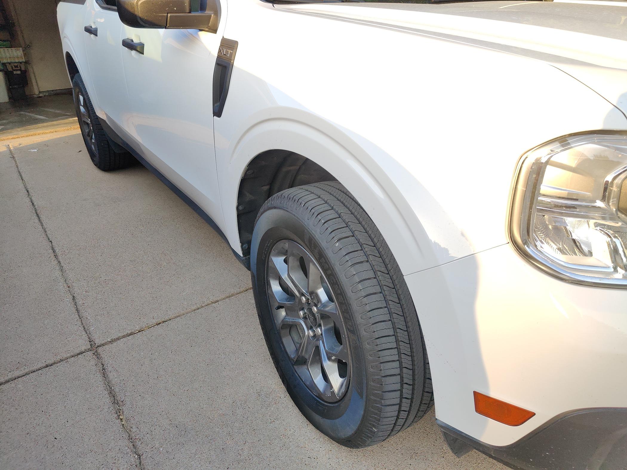

I put defender2 235/65/r17 on my hybrid. I don't think that it makes a difference in the mpg, except for the extra weight. They've been great so far. Recommended.
