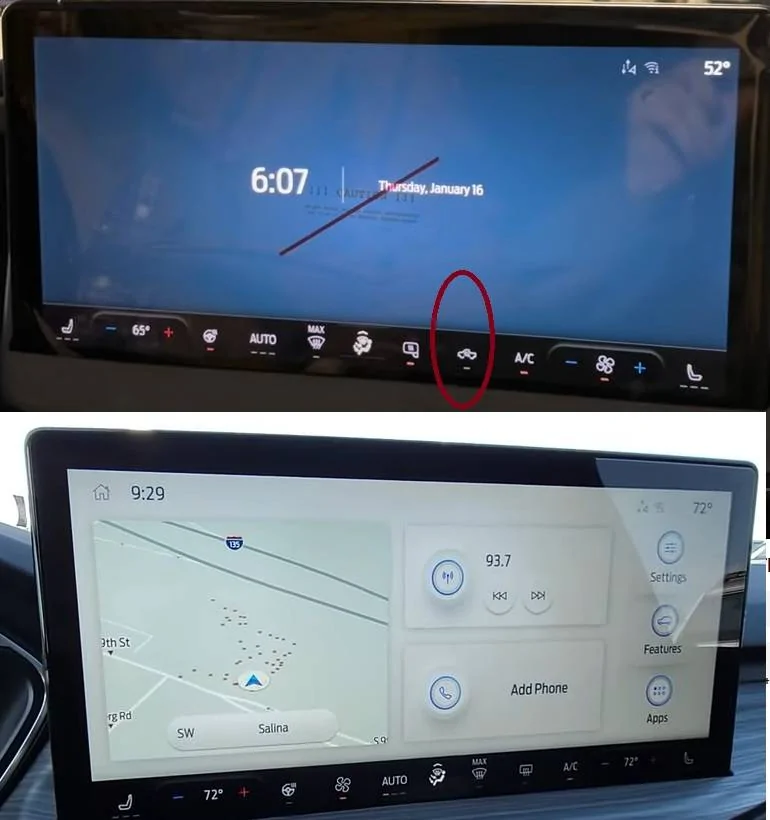

I have a 2025 XLT no LUX package only Co-Pilot and I have the recirc button available.
Lariat does not. I would like to add it

On the Lariat you just tap the vent direction button and it pops up with the option for recirc.
Which is what I said. There's no button on the display, you need to go to a sub menu which is not ideal
