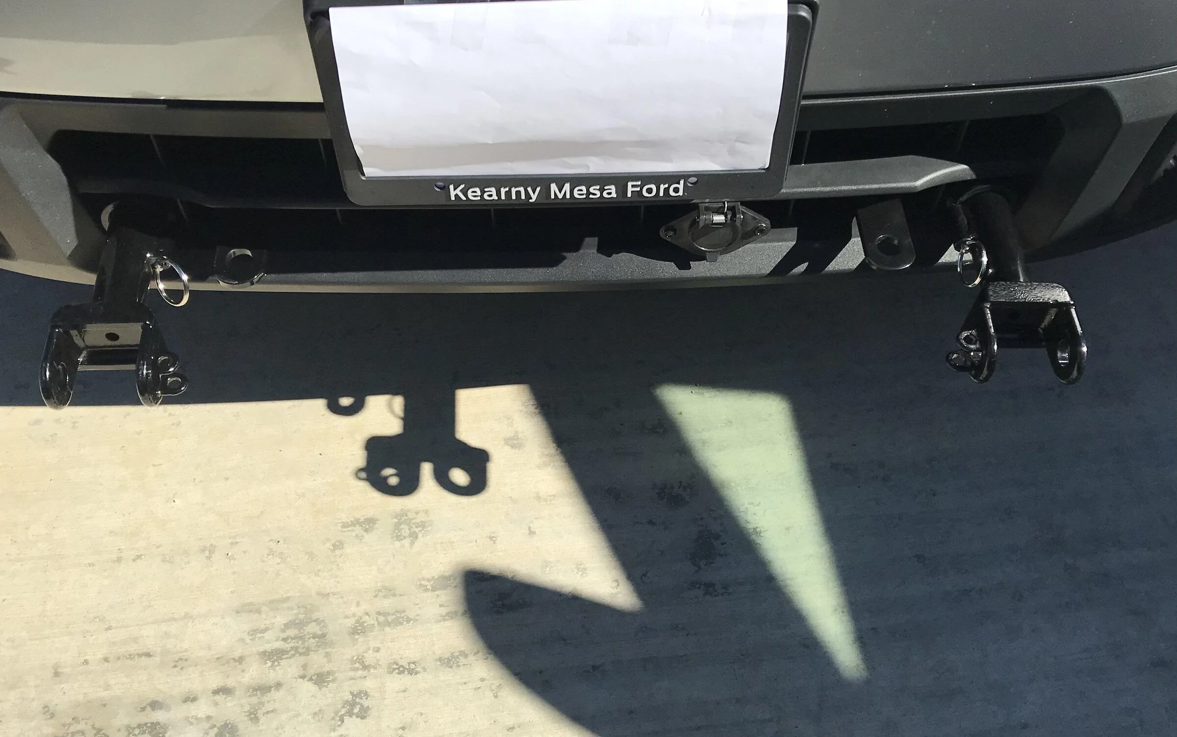

Best looking baseplate by for is Roadmaster’s as it goes through exiting openings in the grill versus Blue Ox cutting ugly holes. I used the NSA Ready Brake tow bar that has a built in surge brake that connects via cable to the brake peda. Simple, mechanical, nothing to break and will save you $2k versus any other built in auxiliary brake system for your Maverick. $1,380 for towbar and all brake cables. Run a trickle charge to your battery directly from your 7 way connector. have towed over 4,000 miles with this setup. https://nsarvproducts.com/collections/aluminum-tow-bar/products/rv-tow-bar-ready-brute-elite-ii

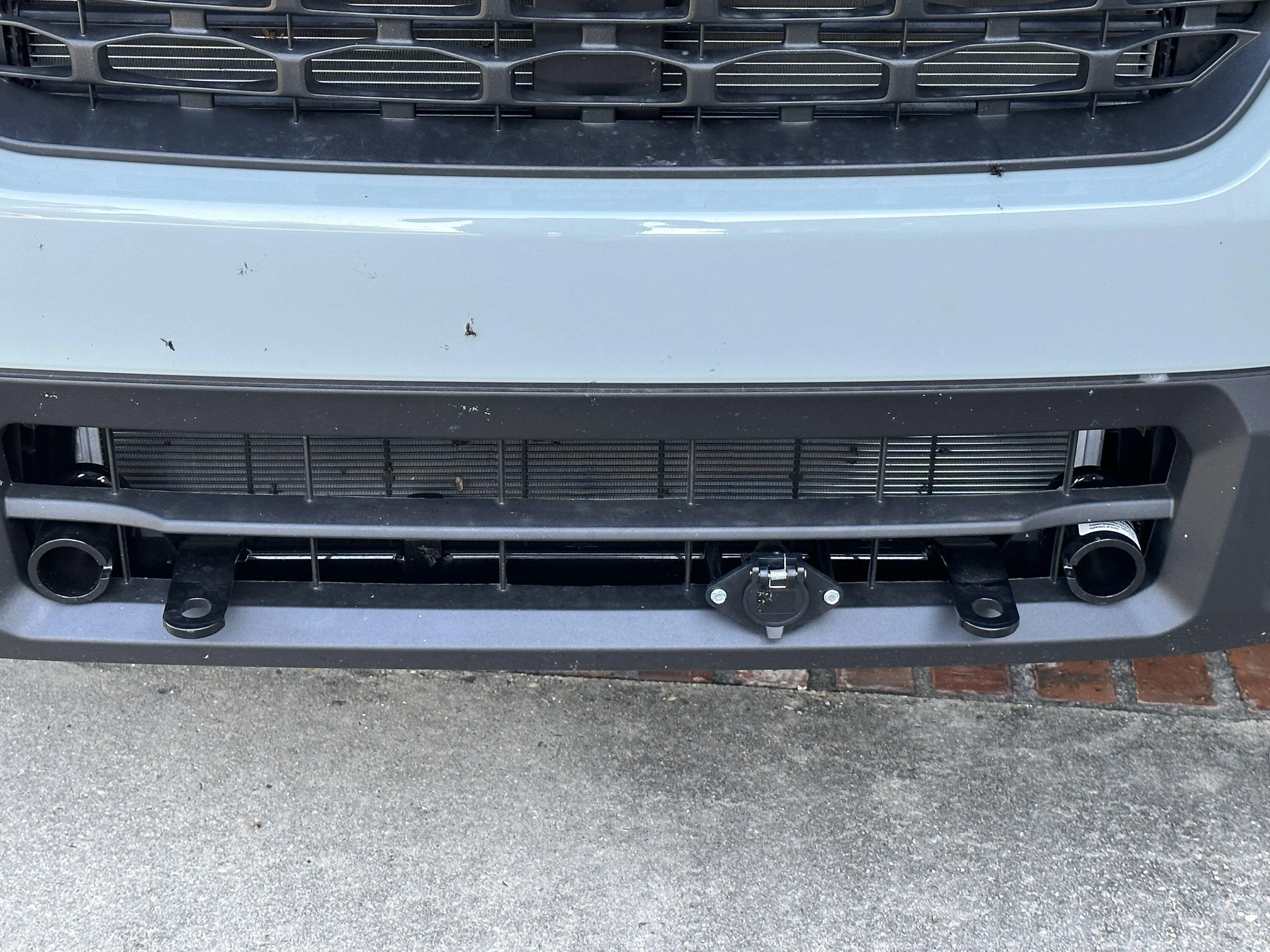

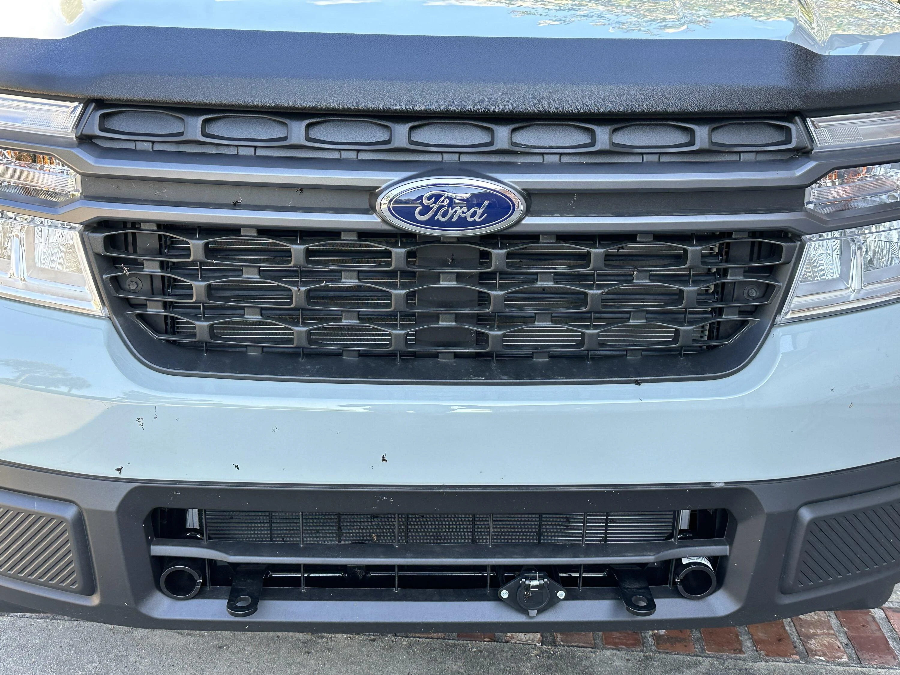

I just had the same installed, but the installer said that they couldn’t install the mechanical braking cable through the firewall in correct spot to attach to the brake pedal. I have the hybrid. Were you able to install the mechanical brake cable that comes with the Ready Brute Elite tow bar? Thanks for your input!

I have the Ready Brake system set up on my Maverick. Don't know why they said they could not fit the cable through the firewall? Mine works fine and it wasn't complicated at all.
The only "issue" I had was figuring out a way for the cables other end to come out in the center of the lower grill opening like it is supposed to. I built a standoff mount to bring it forward so the bend in the cable was less severe.

Didn't take any pictures. Rather tight working area and hard to get a drill in there to make the hole. A smaller air powered 1/4" drill really helped with that. The connection to the brake pedal lever is straightforward. I did what the instructions show to do and it has never needed attention since installation.

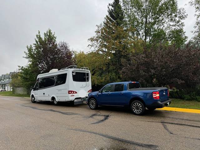

Just got my 2022 Maverick XLT Hybrid in December and now am ready to flat tow it behind my motorhome. Has anyone had any recent experience with flat towing the Maverick, advice/concerns?
Thanks for the help.
TW
I have towed my 2024 hybrid lariat 3,000 miles so far and it handles it great. My only issue was I tried using an older brake and it was to harsh on the electric brakes on the hybrid. Had to buy a new blue ox brake with a hybrid setting. Then all is good. Max 70mph, and exercise every 6hrs. Is a pain but once you are good at putting in and out of toe mode, it doesn't take long. Love it.

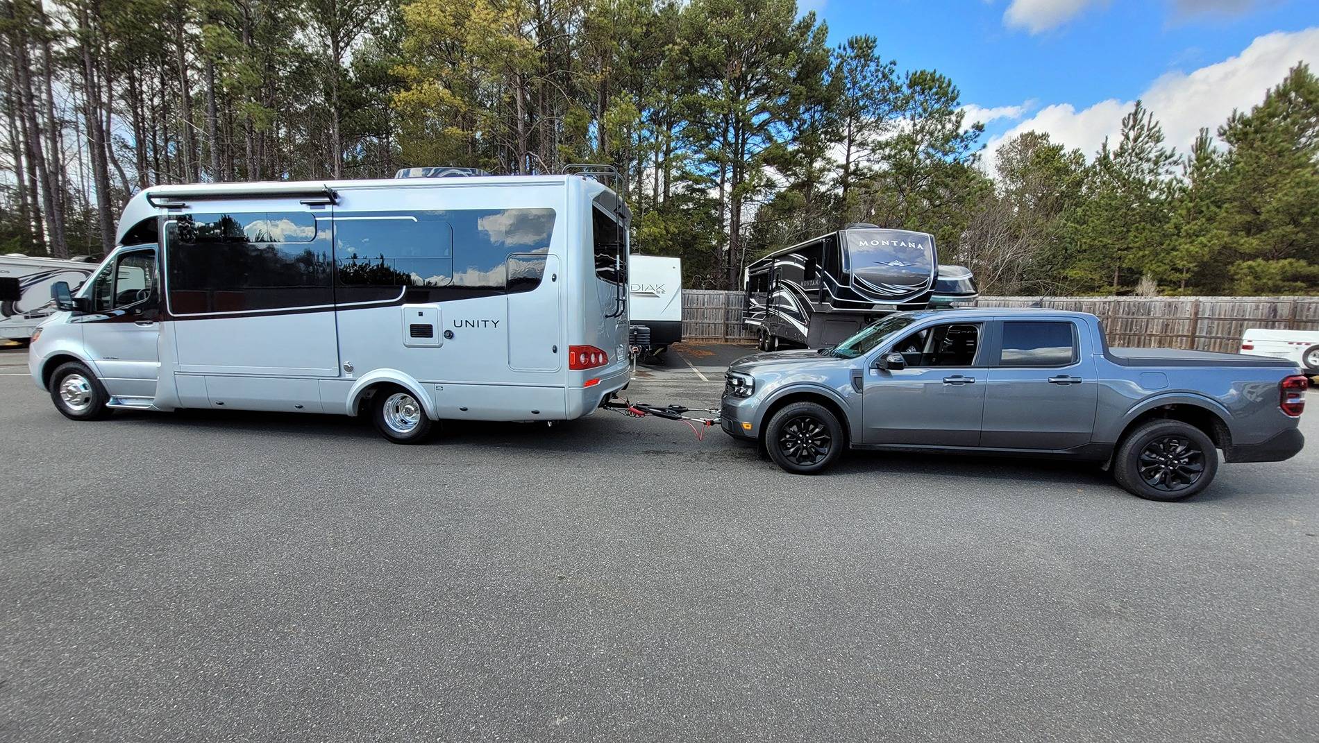

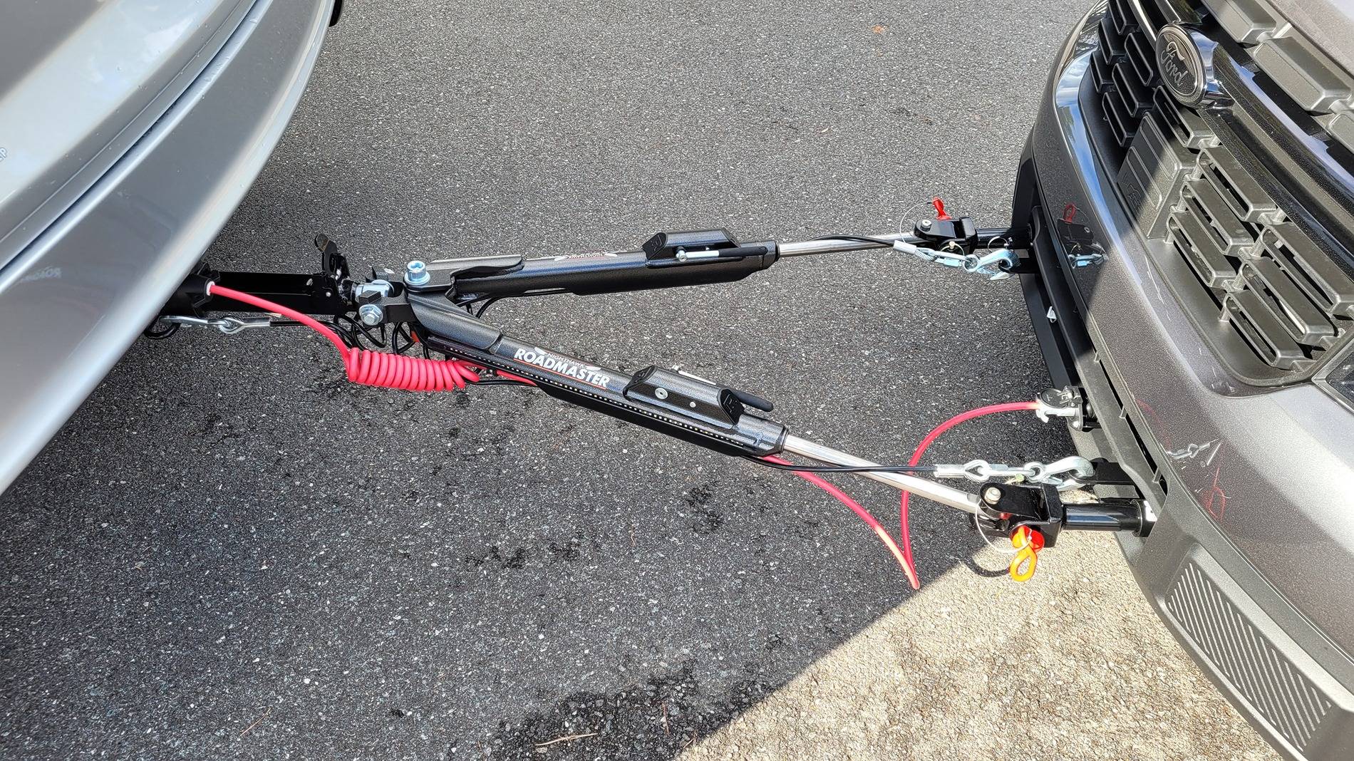

1st post..I have 1,500 miles on my 24 hybrid lariat and really enjoying it. One of the primary reasons I got it besides needing a vehicle, is for the flat tow capability. Ive never flat towed a vehicle so lots to learn there. I went with the Roadmaster baseplate and Knighthawk tow bar. I connected everything today to verify fit and function and everything checked out. I'll take it for a tow in a few weeks when I have more time. Couple pictures of my setup with the Unity LTV.
