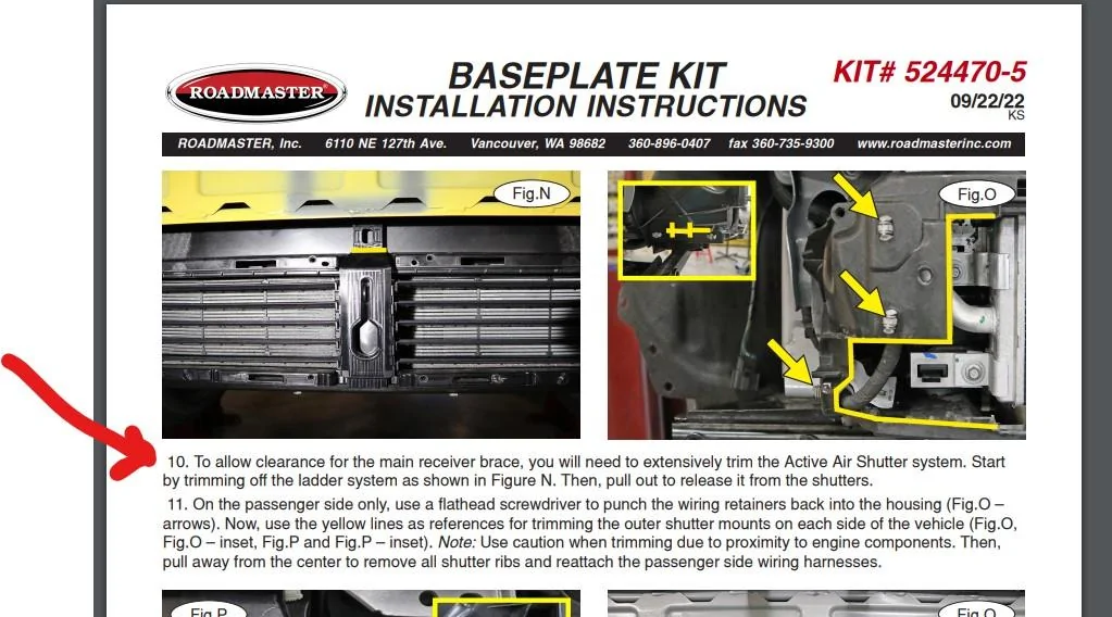

Do you have a shot of the front of the Maverick? I'm planning on getting Roadmaster to install the base plate and curious what it looks like and what they had to remove.
I just got my Roadmaster base plate installed last week. I will put a picture out this weekend. Looks great! and yes they had to remove the very bottom lover.
That Roadmaster baseplate requires you to destroy the lower stutter system As Ford says, the shutters are for heat management AND mileage. I don't believe it is truly harmful to remove the structure, but I'm not Ford who will be looking for any reason to deny a warranty claim.
@Palms has a great combo, with the Blue Ox baseplates and he replaced the lower Hybrid fascia with the FX4 lower fascia. Makes irt much nicer looking.
