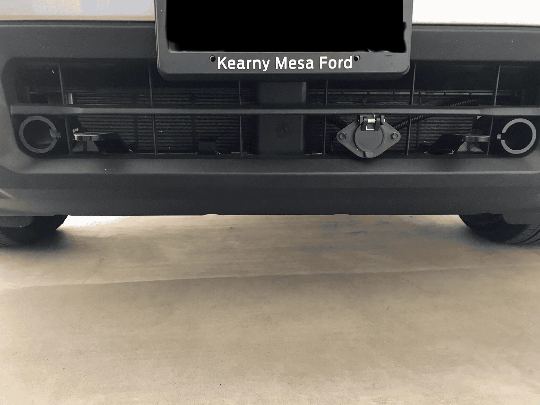

My hybrid with a Roadmaster baseplate
Ford Maverick Flat tow a AWD with it in neutral and the engine idling? D77BCE31-F44A-4E87-96D7-DD57DFDD55E9
