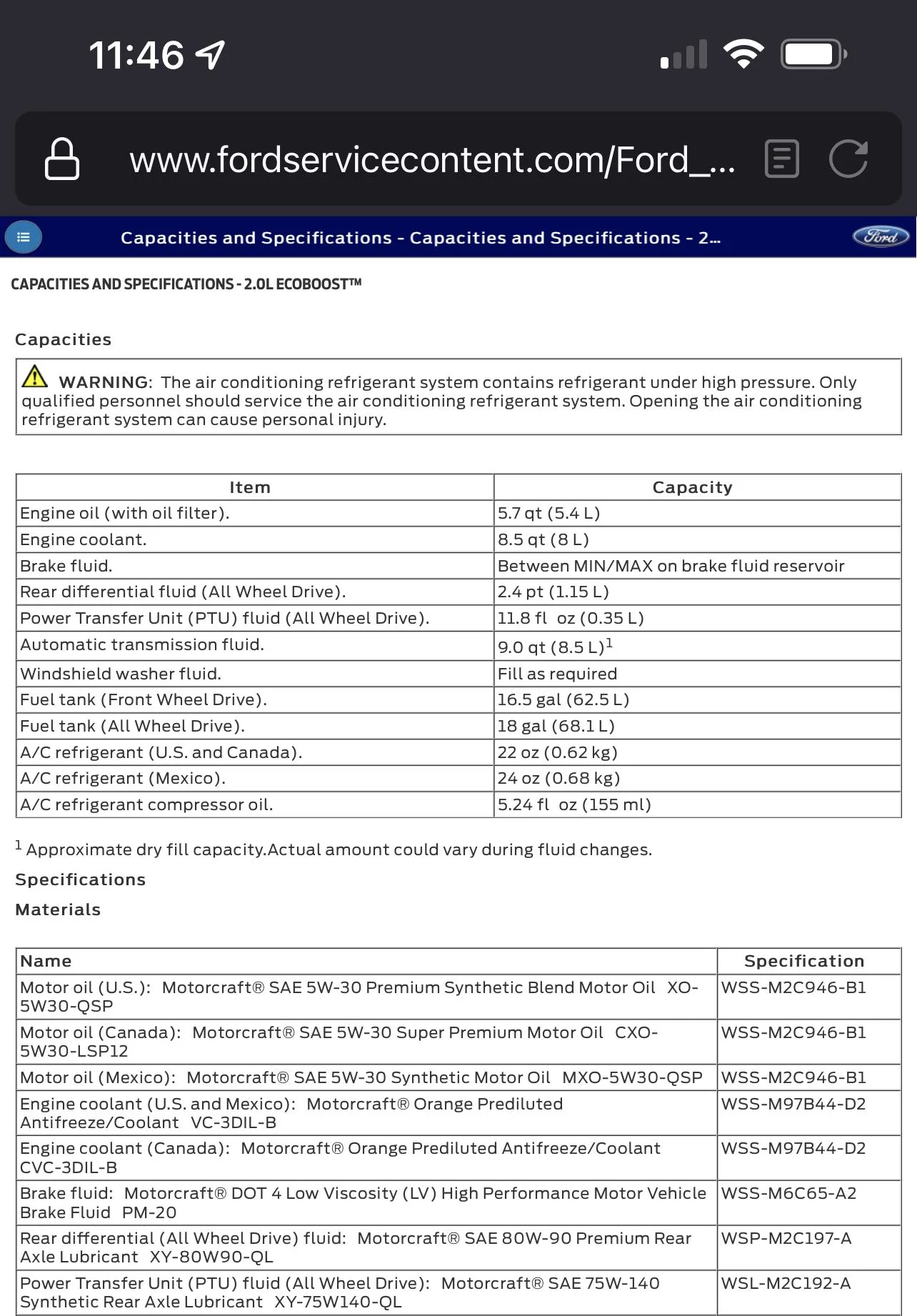

According to Ford, the recommended fluid is 75W-140.
Link? that's not in the manual.
Edit: also the site link in that image is not an official ford site as near as I can tell,.

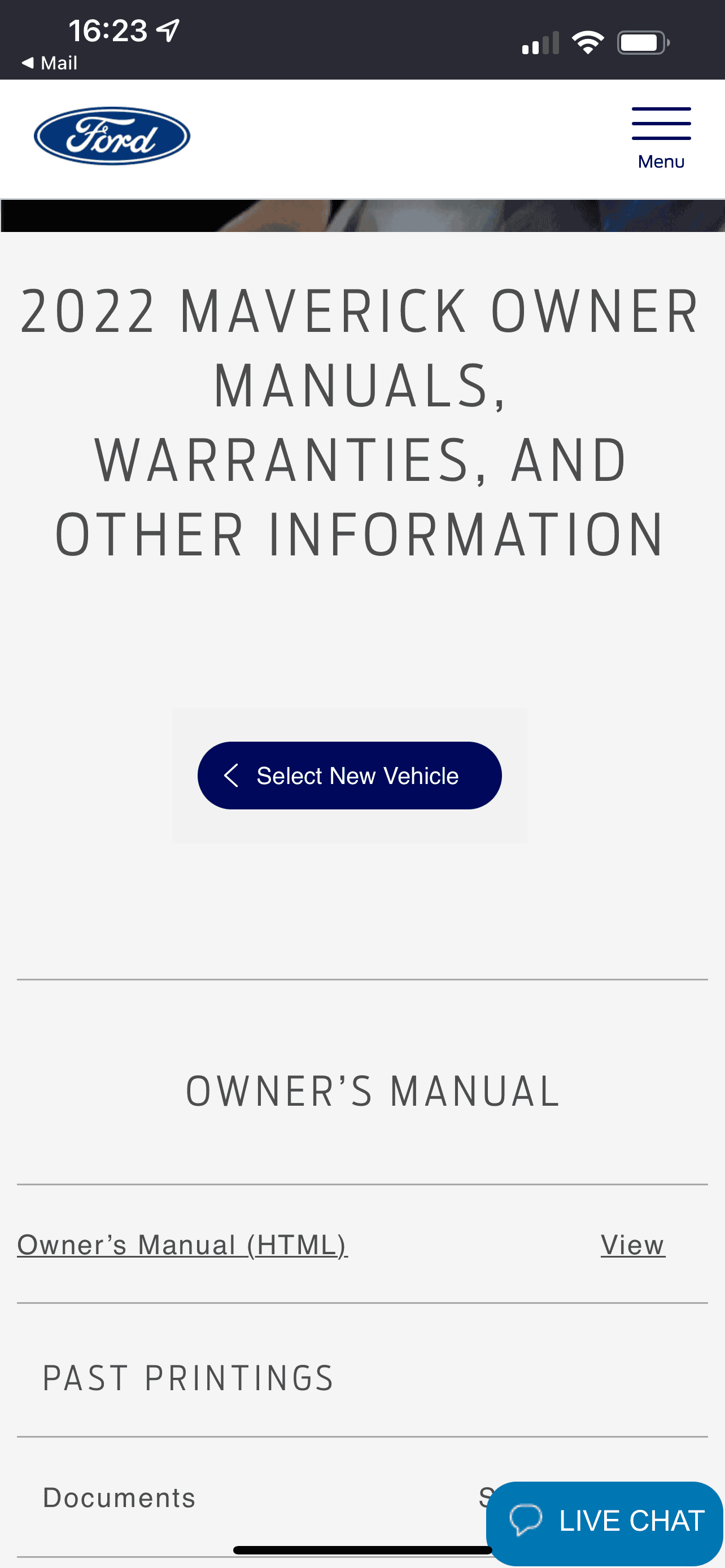

This is directly from the html version of the Maverick owner's manual. Straight from Ford.
Click this!
Click this!
That is also an older revision of the manual, see here
Click this!
It's 75w85 in the Maverick.
Your Owner's Manual link is for a 2017 (about) Ford Escape. Notice how the engine oil capacity is wrong (5.7L, should be 5.5L), and the engine oil spec is the old WSS number, all clues that it is not for a 2022 anything.
That said, I've seen Toyota AWD PTU call for a thicker 75w-140 if Towing, so I doubt if it would really hurt a '22 Mav ecoboost transfer case to use 75w-140.

This is the link I clicked on, to get to the manual I referenced.

Yeah ok, it's weird. That site is where ford redirects you when you search for the manual. Why do they redirect? Odd.
Anyway no matter how I search I can't find that particular page. Can you post the full URL?? The one to that page.
