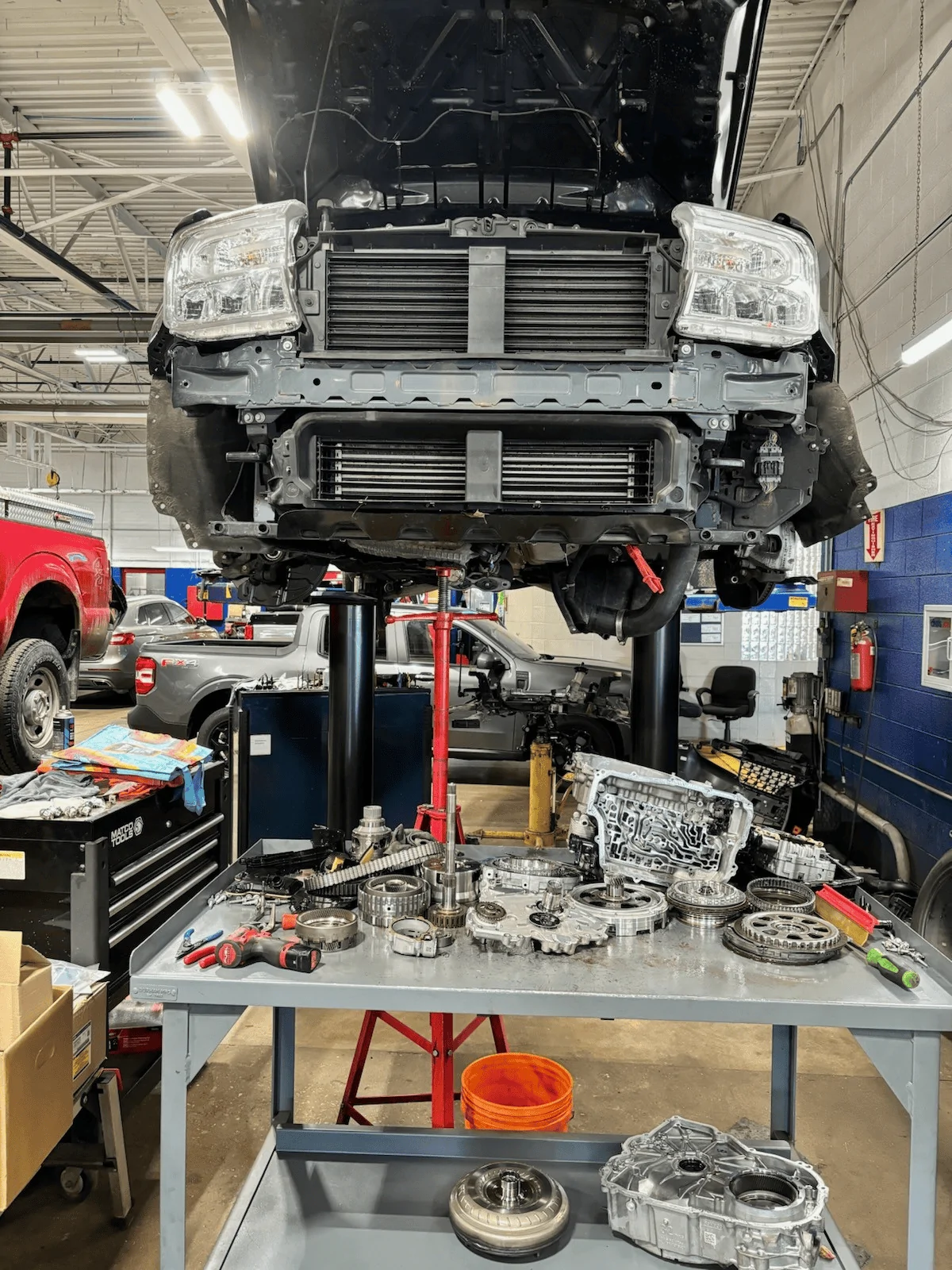

Just a quick follow up @801Maverick801 .
At ~41k miles, my torque converter failed and sent some metal through the transmission. One of the clutches was burnt up as well as a few parts with damage from the metal in it. I'm relieved this happened before 60k miles as the powertrain warranty is covering all of it, but pretty concerning overall. I never towed anything with it (this has the 4k tow package) and never took it off road on any rough trails. Mostly all highway miles and city commuting. Keep in mind for everyone else that I did have the dealer flush the PTU fluid at ~31k miles; but I'm kind of scratching my head how that dealership didn't report anything was up at that point in time unless the issues started happening after that. My tech who has been communicating with me just mentioned this is the same torque converter that goes in the Ford Edge and he said they replace those often. :(
I'm sorry to hear this happened to you. I'm glad it happened within your warranty period though.
I'm still guessing they screwed up your initial service you had. It sounds like you said things started acting up after the service? That indicates improper maintenance to me. Unfortunately it's pretty impossible to prove at this point. Those transmission clutches won't burn up with that low of miles and city/highway driving.
There is a massive tech shortage right now, and alot of the techs doing work aren't exactly experienced either. Im still guessing the guy accidentally drained your transmission instead of the PTU and didn't fill it at all. I drained about 6 quarts when I did my transmission drain and fill. There is still a few quarts inside and would make sense that it would partially work for a while and then start burning up clutches/torque converter.
Something was done wrong when you had the work done. Please refrain from discouraging other members to do early services.
