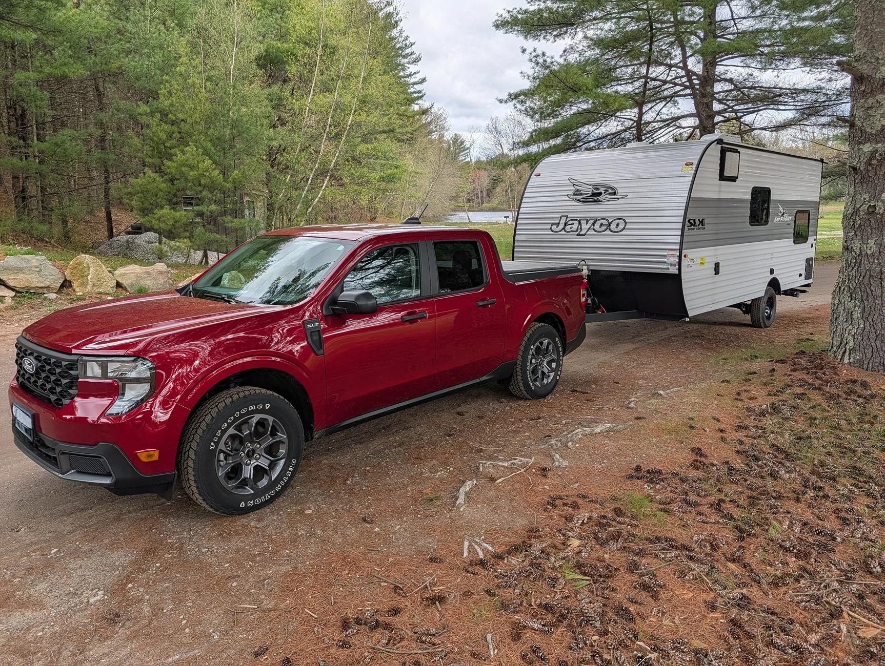

Had our first camping trip with the Trailer this past weekend! The past few years we have been tent camping and it was time for an upgrade! What an awesome experience it was. We picked a close camp ground for the first trip to make sure everything worked with our new Trailer. It was only 20 minutes from our house but it felt like a different world for 2 days. I always said I wanted a cabin in the woods and now we have a little cabin we can take places! The weather was chilly. It got down to the upper 30s one night and only upper 50s during the day. It also rained for a while. But the heater in the camper worked great and sitting by the fire at night listening to the owls with a full moon was awesome! The kids had a blast. You know its a good trip when they are crying when we had to head home. My wife had a blast and our dog loved exploring everything!
My Maverick handled the trailer (2025 jayco jay flight slx 170bh) without an issue. I would say loaded the trailer was around 3200lbs (empty its 3000lbs). Tongue weight was probably just under 400lbs (empty its 300lbs). It was all back roads to the camp ground with some very steep hills. Max speed on some of the roads I was going 55 (50 speed limit). Averaged around 15mpg. Can't wait for more adventures!
