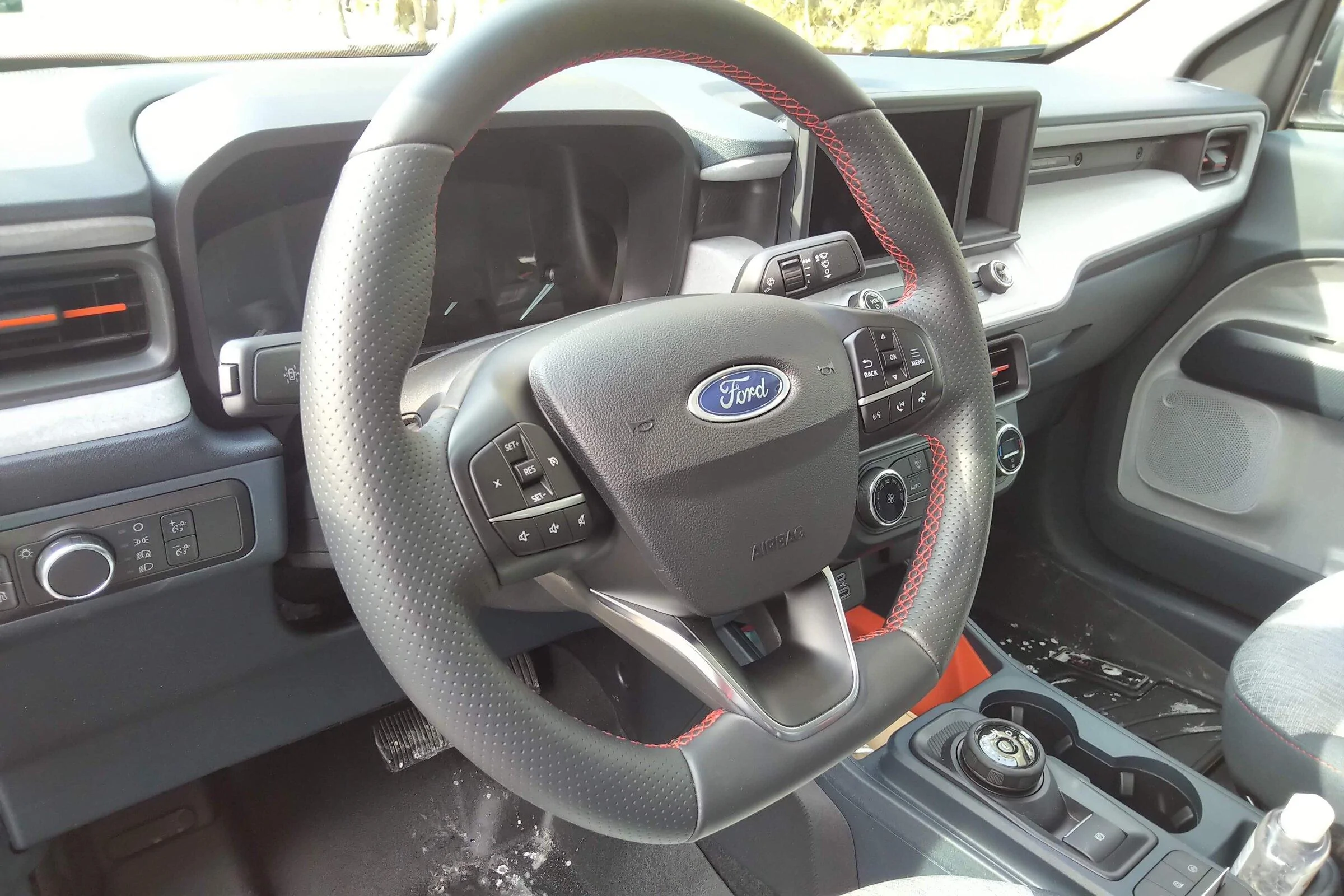

Thanks for this thread; I just did the swap on my non-Lux XLT hybrid. It looks and feels way better than the stock plastic wheel!
Via eBay I purchased a wheel from a 2020 Fiesta ST from the U.K., got it in a week. I picked one with red stitching to match my hot pepper red exterior, the ones with black stitching are available as well.
I had to swap the wiring harness in the steering wheel as well as both switches (I could have swapped just the left one). Also, go buy a Torx T8 screwdriver, you will need it for the switch screws. As I discovered, a T8 is not commonly included in Torx sets.
Via eBay I purchased a wheel from a 2020 Fiesta ST from the U.K., got it in a week. I had to swap the wiring harness in the steering wheel as well as both switches (I could have swapped just the left one). The whole job took under an hour. BE AWARE: disconnect the battery and wait 15 minutes before starting! Also, go buy a Torx T5 screwdriver, you will need it for the switch screws. As I discovered, a T5 is not commonly included in Torx sets.
It is not necessary to remove the steering wheel lower shroud, you can release the airbag clips from above the shroud: just turn the wheel 90 degrees and use a short screwdriver to release one side, then turn the wheel the other way and release the other clip. Turn the wheel straight before removing the wheel. Once the wheel is removed, use a piece of tape to keep the clockspring from rotating.

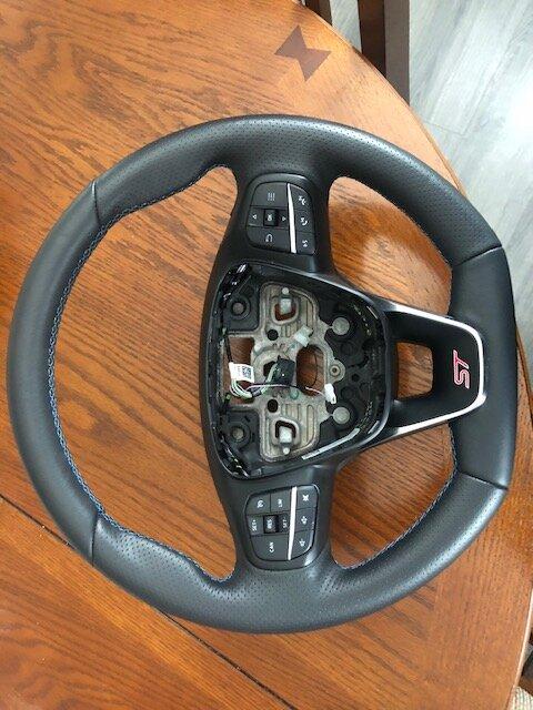

Just received my leather wrapped wheel I purchased on ebay from UK. Got here in about 2 weeks. Had to change wire harness and switches from my XLT for all to connect up in the ST wheel. It really feels comfy with the leather and the flat bottom on the wheel. Cost approx $250 with shipping and has the blue stitching to match my velocity blue Mav.

If your Mav is an XL, you will need to use forscan to activate cruise control as well as buying the switches. Mine is XLT so it was just a matter of moving my OEM switches and the harness into the UK wheel. I really like the feel as well as the looks.
