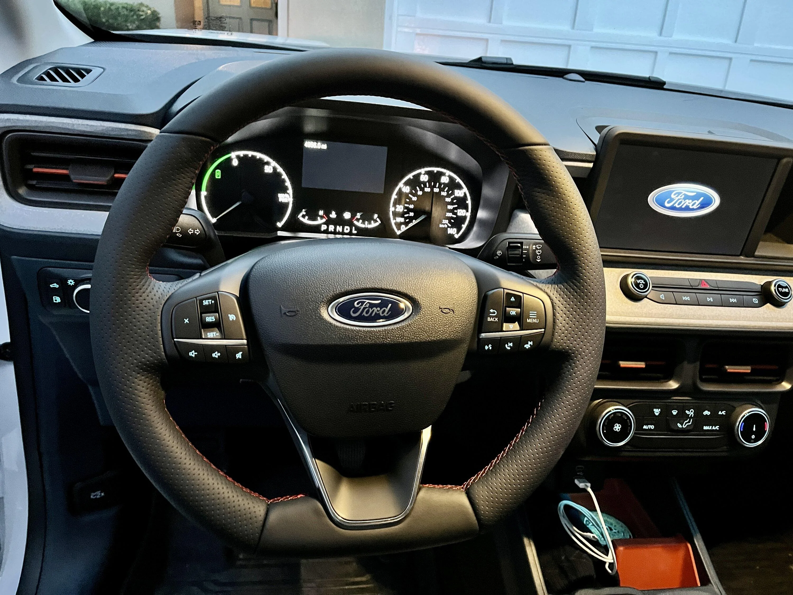

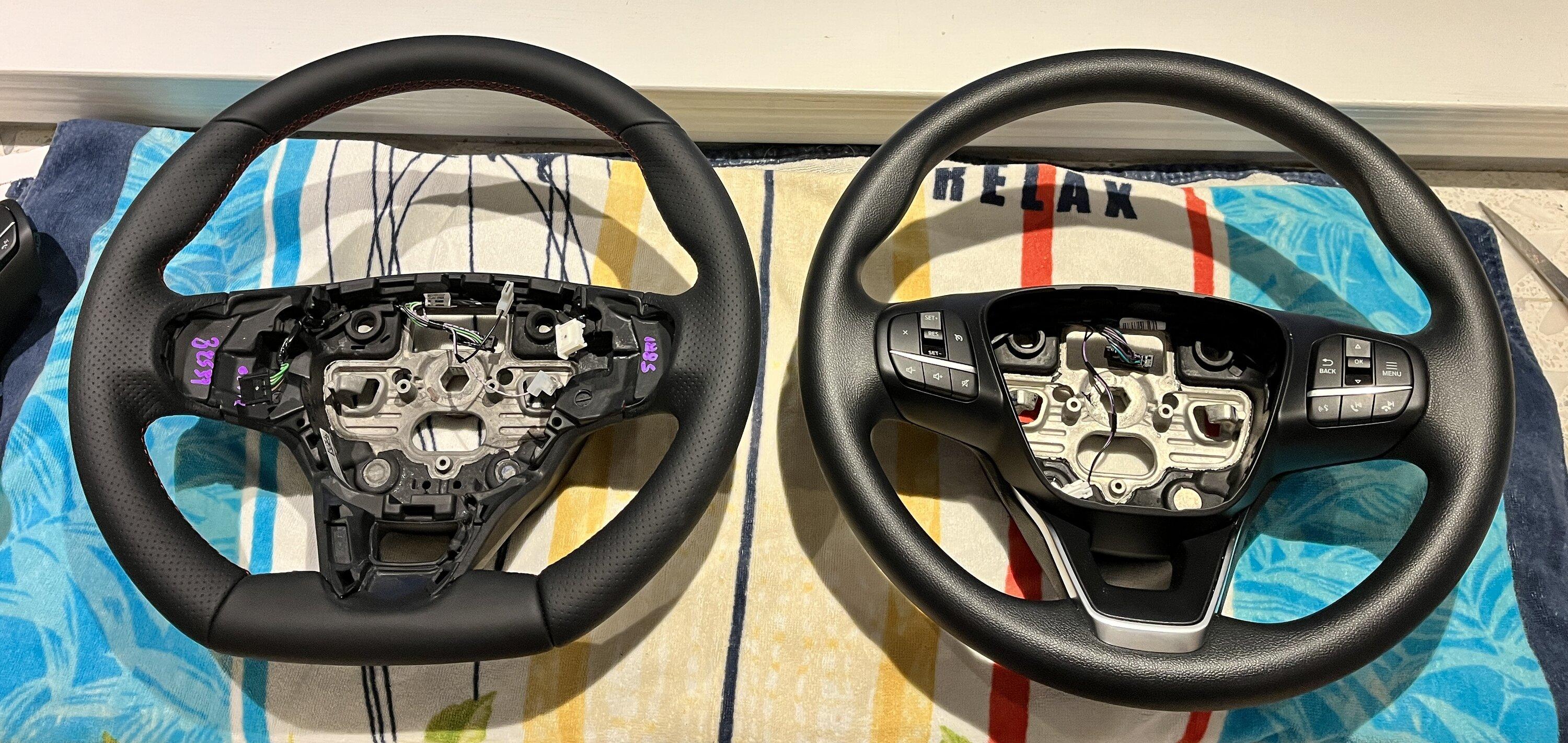

Ordered a red stitching Fiesta ST from eBay with a seller in Poland. Steering wheel arrived in a few weeks. With the help of the YouTube videos, I was able to swap the steering wheel buttons over and wiring harness to the new wheel and install it. I was a bit nervous working with the airbag module for the first time but it was no big deal. Disconnected the battery, and it popped off in a few seconds with a screwdriver type pick. Buy the 8t torx screw driver before attempting. I had a random one in my tool box but my torx sets did not have a standard 8t torx. Total cost including shipping $258.00. Total install time 30 minutes but now could do it much faster.

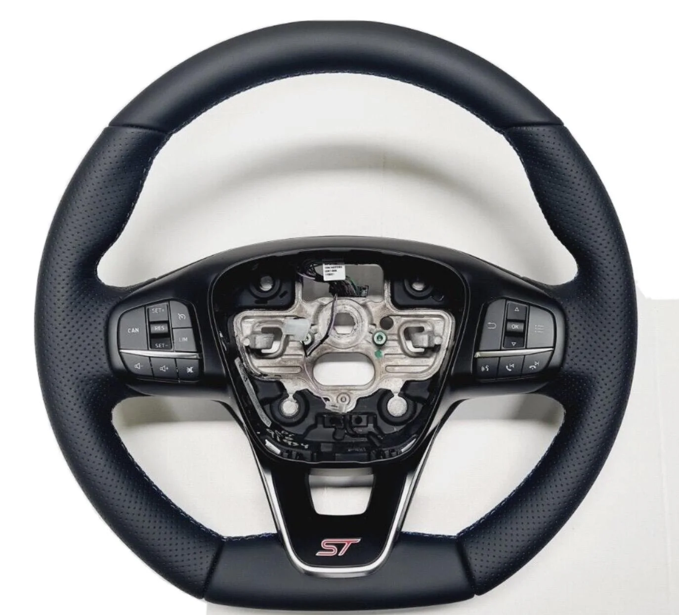

Guys, so I just ordered this wheel from Poland for my 2023 Maverick XL. Can someone please tell me the exact wiring harness I will need? Thanks.
Very nice looking steering wheel.
I used the existing harness from the steering wheel that comes with the XL. Just remove the switches and guts at the same time, and swap them over.
