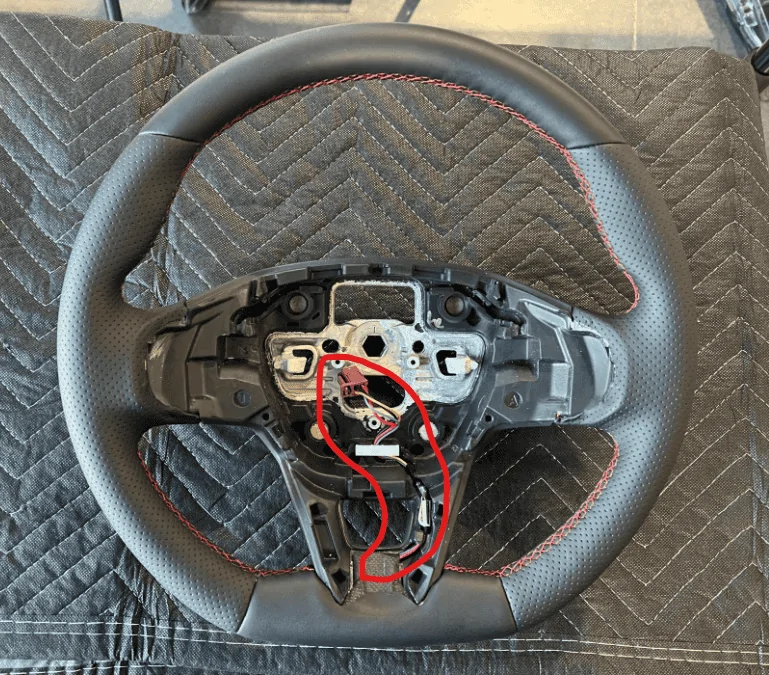

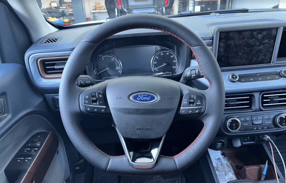

PJ6Z-3600-SD
2023 Escape ST-Line heated steering wheel. The wire coming from the bottom of the wheel is for the heater. If that wire is not present, it doesn't have the heater option.

PJ6Z-3600-SD
Thank you sir!!

PJ6Z-3600-SD
You could add the heated function by adding 2 wires and steering control module lol 😆 😂
This is on the steering wheel side. If the steering wheel doesn't have a thermistor and resistive elements, it will not be able to be heated.
Yea obviously . Neither if you don't have the mod done to it. And enable on forscan. I explained how to DIY this on the forum .
