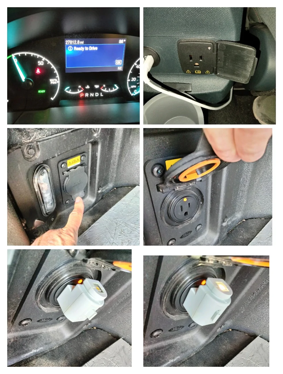

For the new folks that may not quite understand what's being discussed.
I hope these photos help clarify.
My Maverick is in the on position ready to drive.
Ford Maverick Faulty 120v 400w Outlets IMG_20260717_090759
