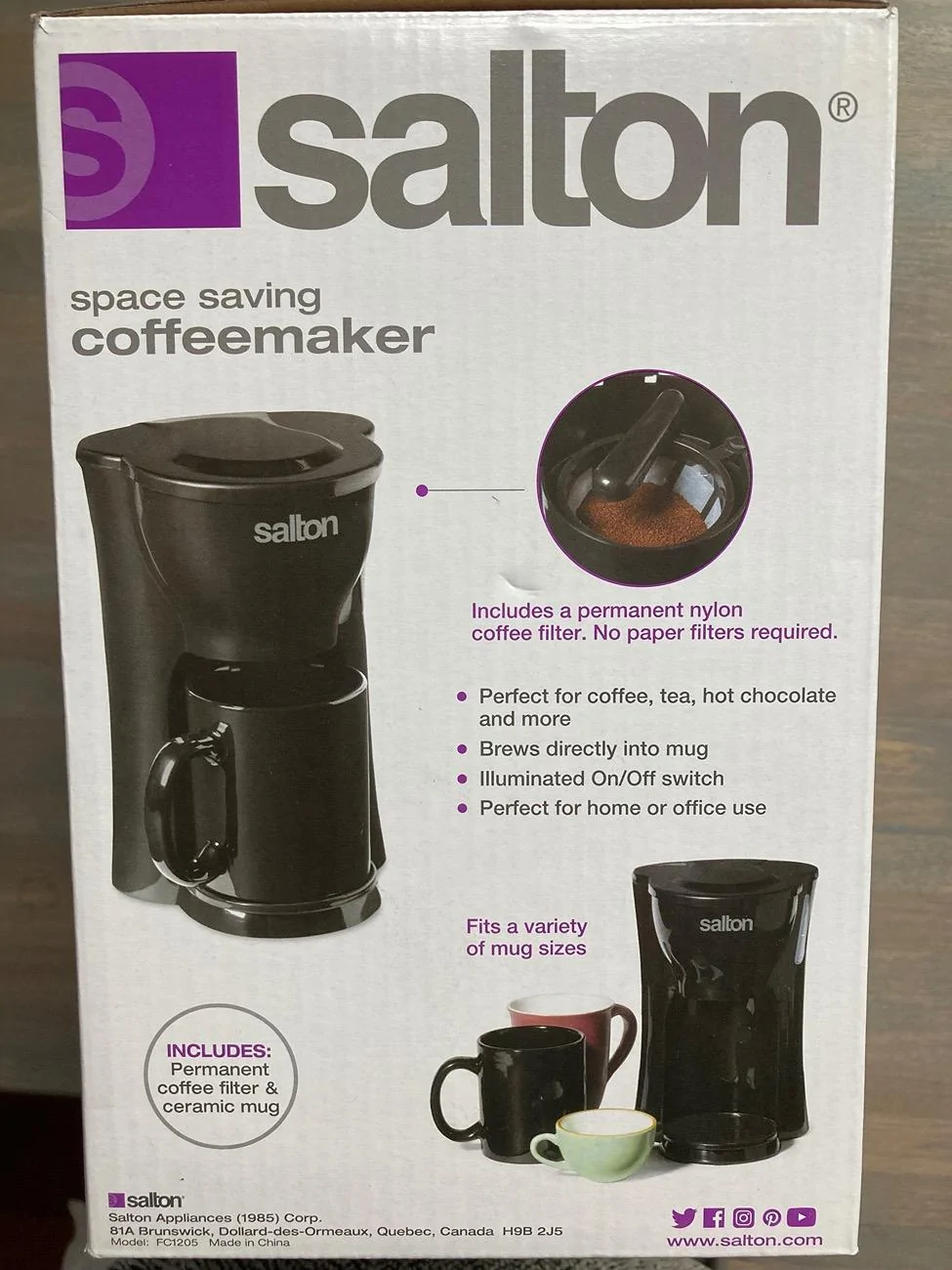

I did a deep search 2 yrs ago for a coffee maker that would work with the Mav 120v/400w outlet. I could only find one that met the standard, which I bought from Walmart and have used several times while camping.

As an electrician I hear ya, though I do have a 4 cup that works, thanks.
